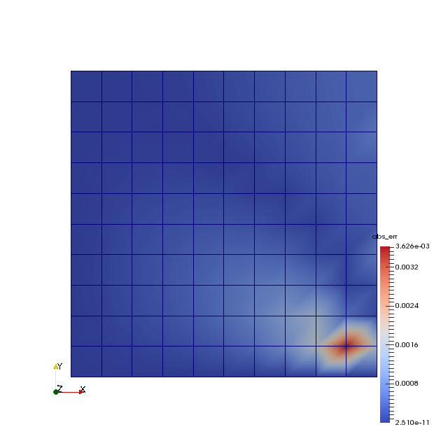

Compared to the analytical solution presented above the results are very good but in a single point:

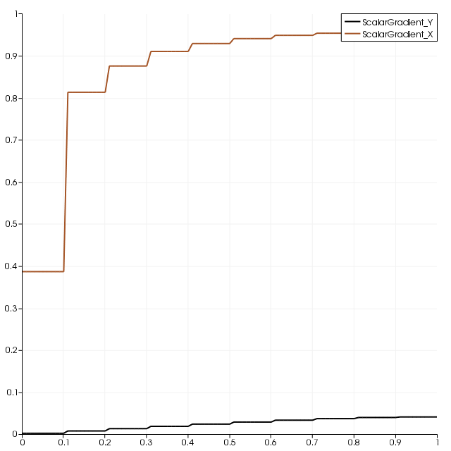

Both Dirichlet boundary conditions are satisfied. The values of gradients in x direction along the right side and y directions along the top sides of the domain a shown below:
The homogeneous Neumann boundary condition on the top side is satisfied (ScalarGradient_Y is close to zero). The inhomogeneous Neumann boundary condition on the bottom is satisfied only for $y > 0.3$ (where the ScalarGradient_X is close to one) because of incompatible boundary conditions imposed on the bottom right corner of the domain.
