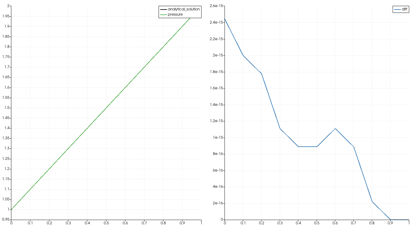

The left figure shows the pressure along the line, in the right figure the difference between the analytical solution and the numerical calculated solution is plotted.
