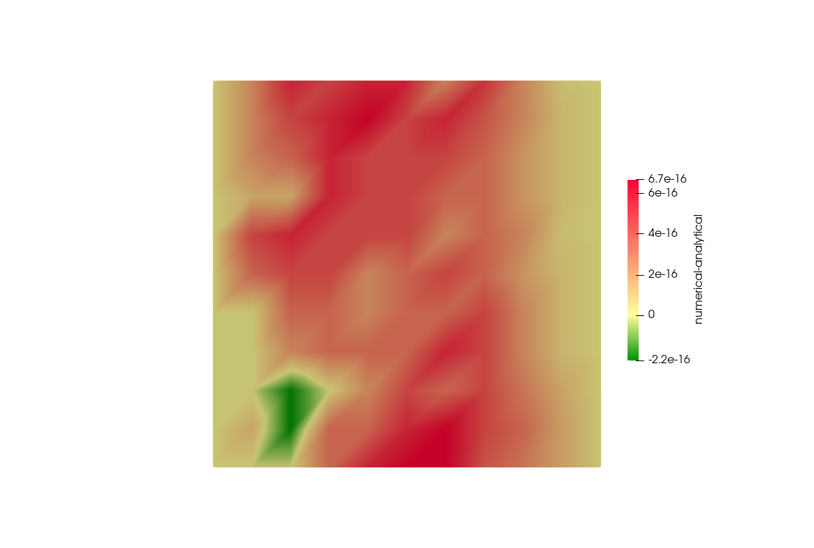

The numerical solution shown in the following picture is almost a linear gradient:

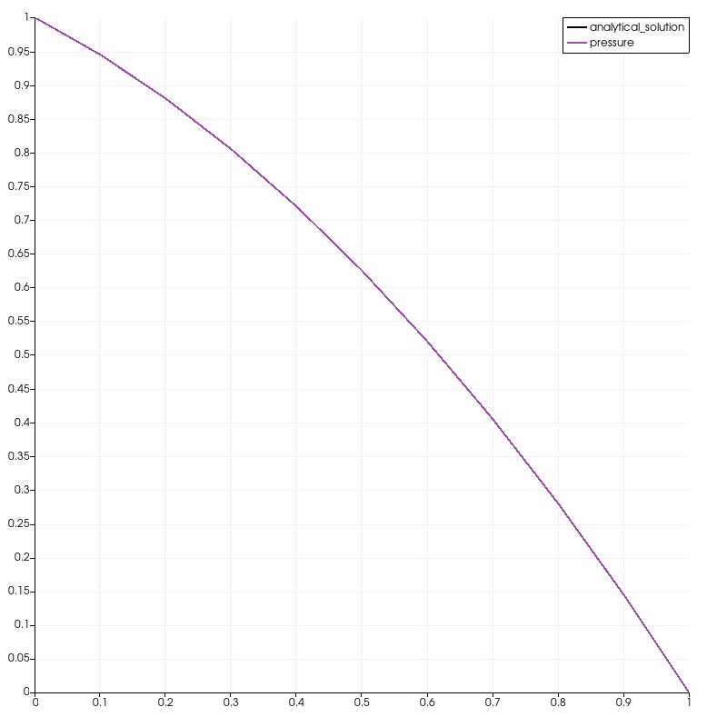

The line plot along the $x$ axis shows that the solution is a quadratic function and is in very good agreement to the analytical solution:
