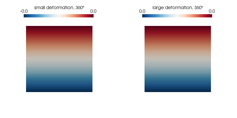

p.show()We plot the normal strain in the $x$-direction for both kinematic formulations on the undeformed configuration as it undergoes a 360° rotation and find our expectations confirmed.
ploteps(0, 0)Expected: 0.00 (small strain) and 0 (large strain)
[0m[33m2026-09-17 15:58:48.020 ( 1.814s) [ 7F902A6D5480]vtkXOpenGLRenderWindow.:1460 WARN| bad X server connection. DISPLAY=[0m
/var/lib/gitlab-runner/builds/K-X1vcp78/0/ogs/build/release-all/.venv/lib/python3.14/site-packages/pyvista/plotting/mapper.py:686: RuntimeWarning: All-NaN axis encountered
clim = [np.nanmin(scalars), np.nanmax(scalars)]
ploteps(0.5, 45)Expected: -0.29 (small strain) and 0 (large strain)
ploteps(1, 90)Expected: -1.00 (small strain) and 0 (large strain)
ploteps(2, 180)Expected: -2.00 (small strain) and 0 (large strain)
ploteps(3, 270)Expected: -1.00 (small strain) and 0 (large strain)
ploteps(4, 360)Expected: 0.00 (small strain) and 0 (large strain)
