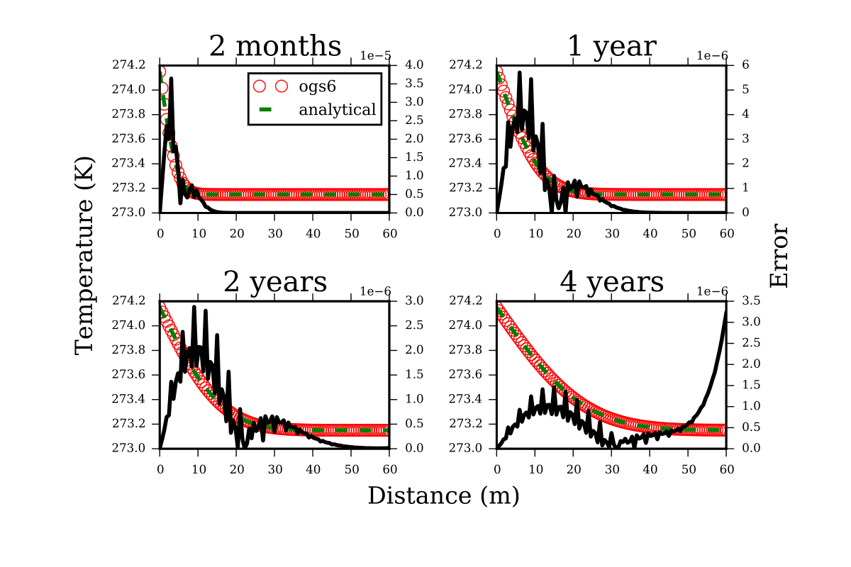

Loading the line_60_heat_pcs_0_ts_65_t_5078125.000000.vtu file in ParaView and Plotting over line. Compared to the analytical solution temperature_analytical.vtu, the results are very good:
