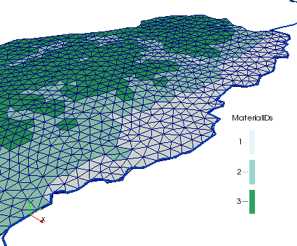

Mesh of the example domain
Shows a mesh of the example domain. Furthermore, a river is depicted (blue color). These data (mesh and geometric description of the river) is given to the tool.

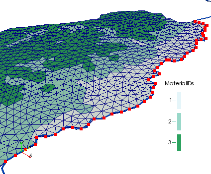

Found nodes
The found nodes will be written to a geometry file which may be useful for visual inspection. The found mesh nodes of the example are sketched as small red squares.
