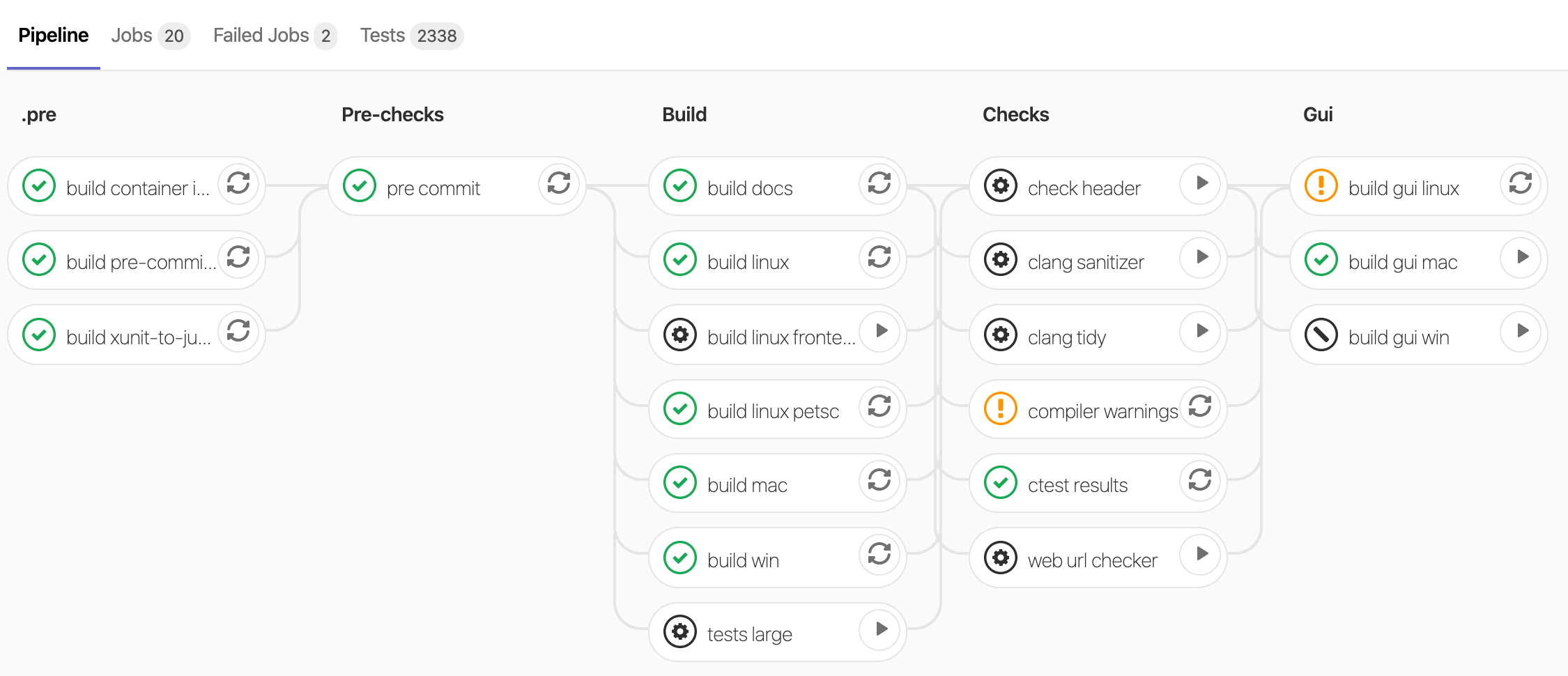

Each pipeline run is visualized as follows: GitLab pipeline visualization
Jobs belong to a stage and each job will get a status (success, warnings, failure). Some jobs are optional (see the gear icon) and can be manually triggered by pressing the play button.
