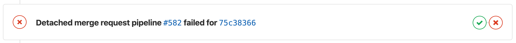

All of this automatically kicks in when you open a Merge Request on GitLab. You will notice a pipeline block at the merge request page: GitLab CI screenshot
Click on the pipeline link or the individual pipeline stage icons (circles) to find out the reason for a failed check. If you add more commits to this merge request all checks are run again.
