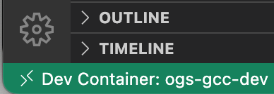

web/content.zsh-terminal with sane defaults (oh-my-zsh).build-directory at the same level as the ogs source code directory.F1 and type reopen in [container], press ENTER.This takes now some time as the container is downloaded from the registry. Once finished you should see the following in the bottom status bar:
ogs-gcc-dev.

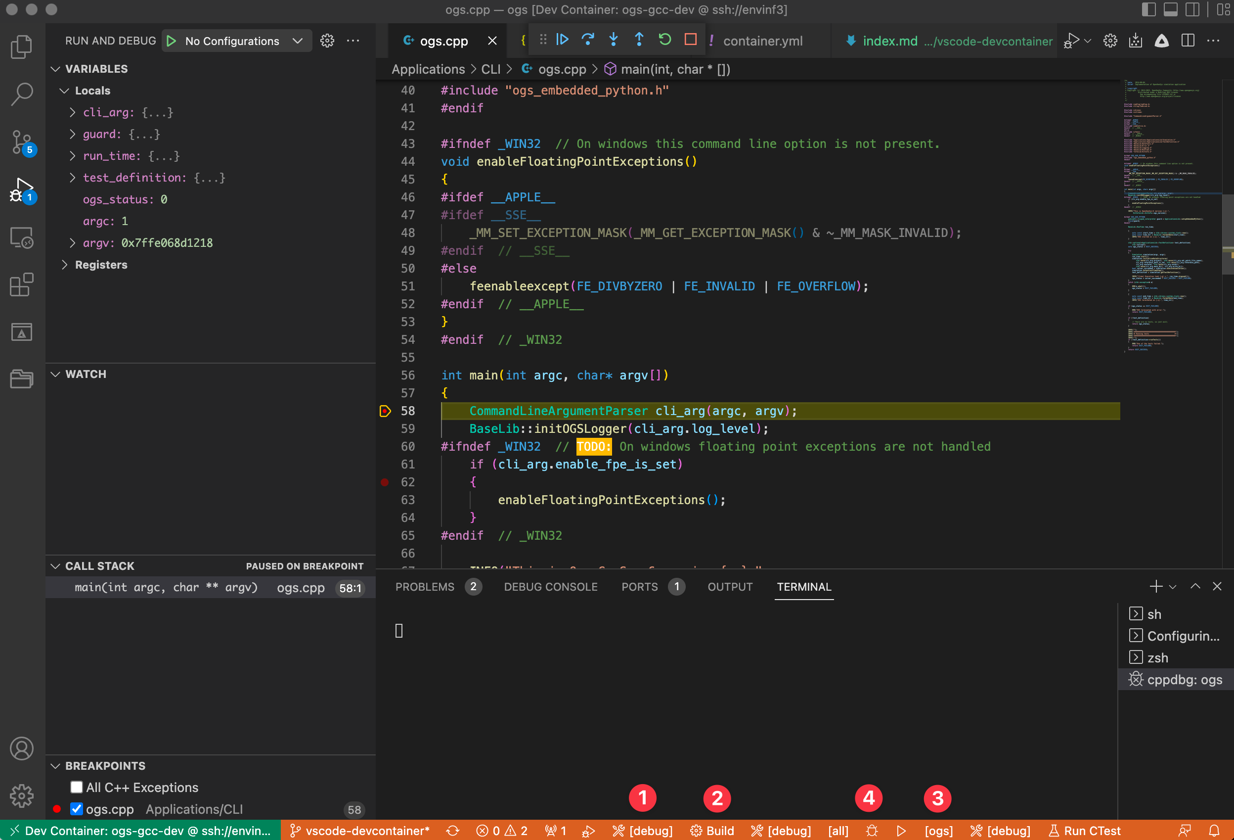

CMake configuration is handled by using CMake presets which can be selected from the bottom status bar in VS Code. See the Configure and build with CMake Presets in Visual Studio Code for details.
In the editor:
ogs.cppmain()-function (around line 58) by clicking on the left gutter in the editor window (a red dot marks the enabled breakpoint).In the status bar:
debug preset.Build button.ogs as the launch target.After some seconds the status bar color changes orange to indicate an active debugging session:
ogs.cpp. Step over lines with the Debug toolbar buttons on top. See local variables on the left.
