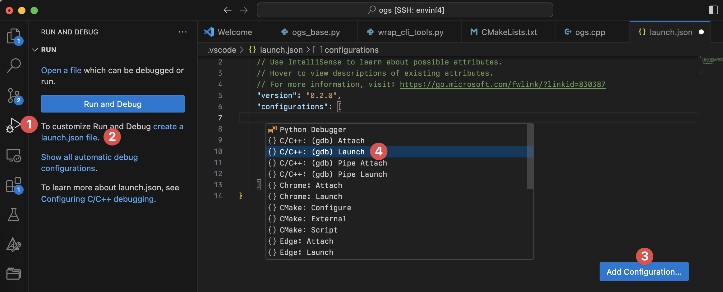

Configure debugging
Create .vscode/launch.json:
[ "${PWD##*/}" = ".vscode" ] || cd .vscode
cat > launch.json <<EOF

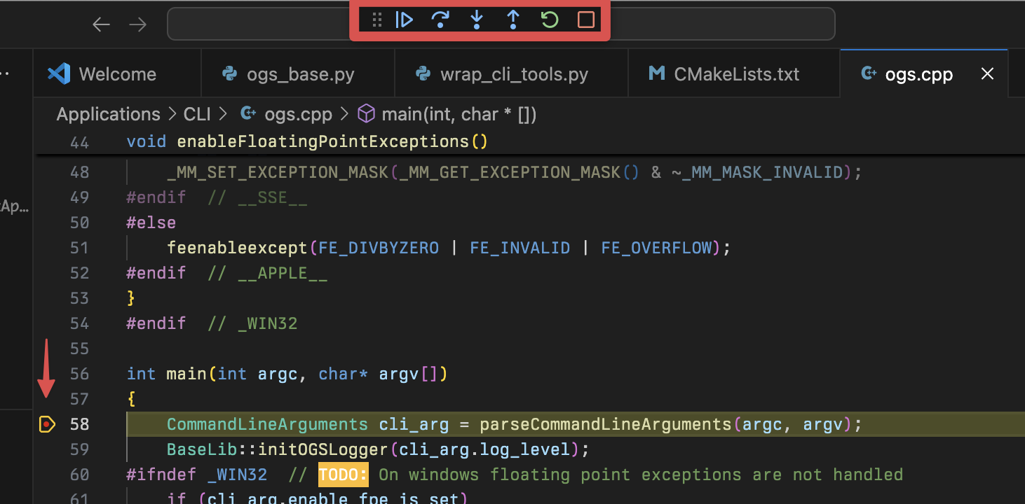

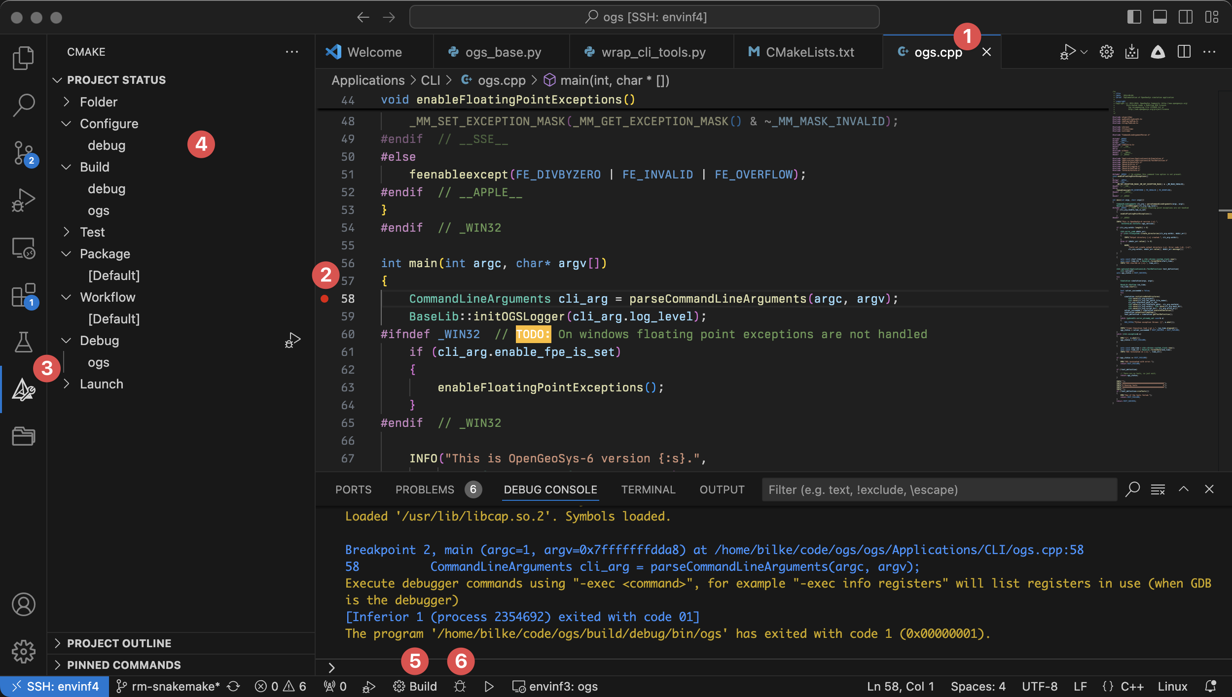

4. Start a debug session
  1. Open the file Applications/CLI/ogs.cpp.
  2. Set a breakpoint at the first line inside the main() function. Start debugging
  3. Start debugging by clicking the green “Run and Debug” icon, or press F5 (Linux) / Fn + F5 (macOS).
  4. Choose the debug configuration by its name set in launch.json (e.g., Debug with LLDB). Running debug session
  5. The debugger will stop at your breakpoint. You can now step through code, inspect variables, and use the debug toolbar to control execution. Running debug session
