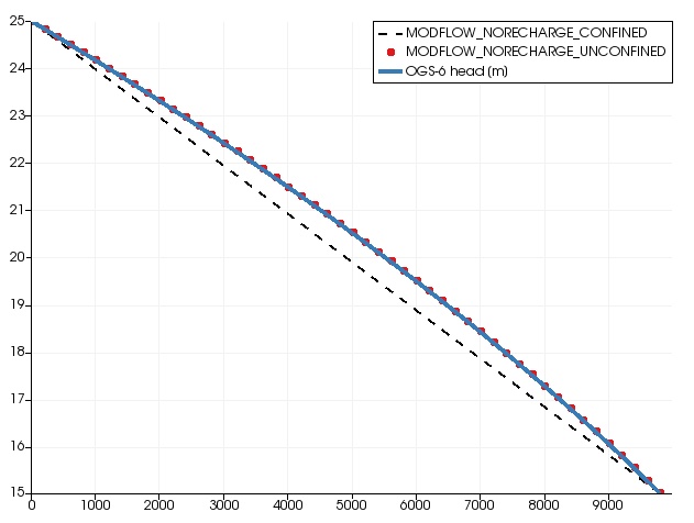

  • Steady-state model.
  • In the north there is a fixed head boundary condition with 15 m.
  • The southern boundary has a fixed head boundary condition with 25 m.

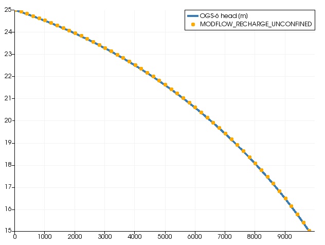

  • Like scenario A and additionally
  • with an average groundwater recharge rate = 3.54745E-09 m/s

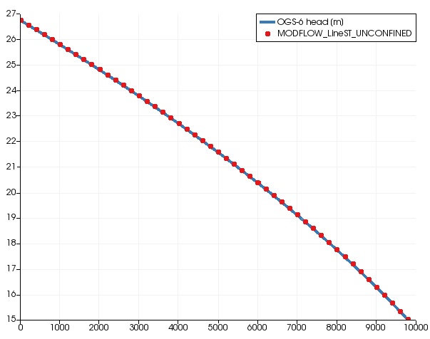

Scenario C
  • like scenario A but
  • with an inflow rate of 4.62963E-05 m3/s per meter at the southern boundary

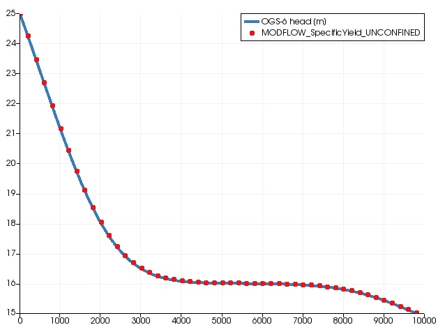

Scenario D
  • like scenario A but transient and
  • with a Specific Yield $S_y_ = 0.25$.
  • Simulation time = 100 days.
