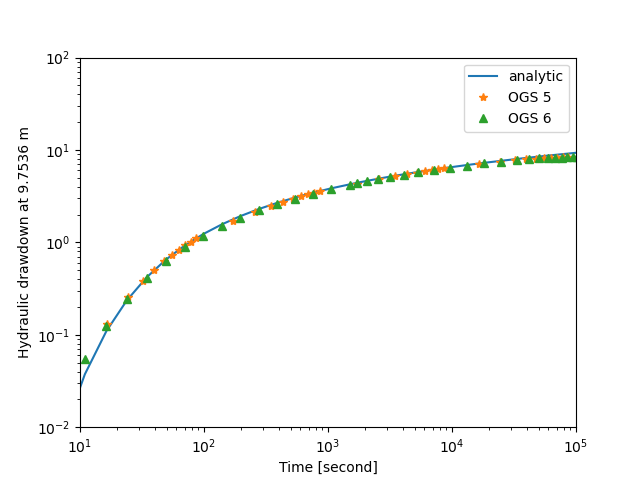

Firstly, we examine the head variation at a point $r=9.7536$ m, representing the observation position. The figure below compares the head variation obtained by using the analytical solution, the result from OGS-5, and the result from OGS-6, respectively, within the time interval [10, 10$^5$] s.
Head variation

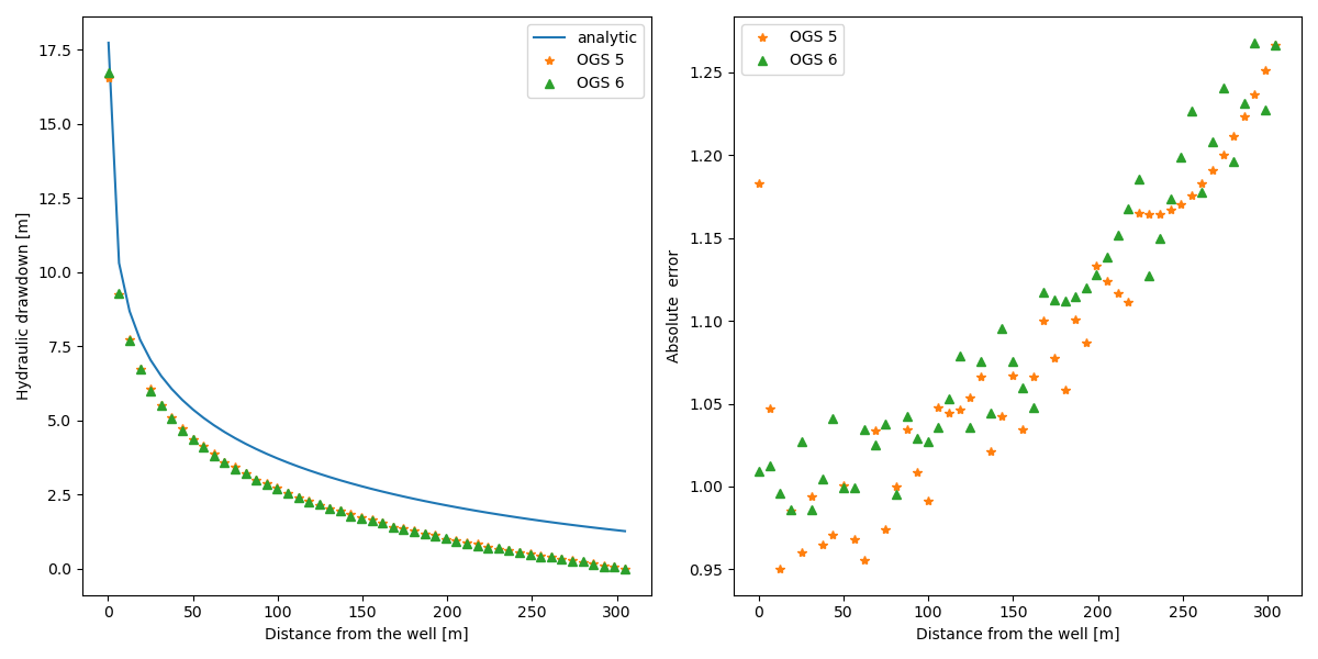

The figure demonstrates a good match between the analytical solution and the numerical solutions obtained using OGS-5 and OGS-6 within the time interval [10, 10$^4$] s, consistent with the results provided in [2] and [3]. A similar good match is observed in the following figure, which compares the head profiles at t=1728 s:
Head profile at t=1728 s At the point with the largest head value, the absolute error of the numerical solution is approximately 0.34.

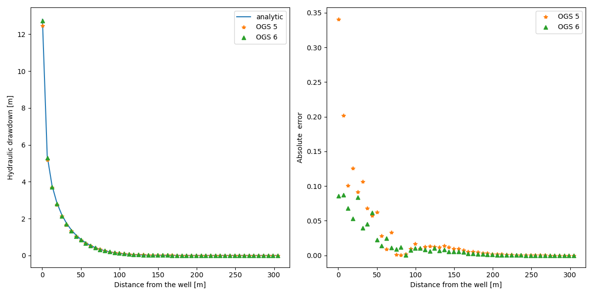

Beyond 10$^4$, an evident discrepancy arises between the analytical solution and the numerical solutions. This discrepancy increases over time due to the inability of the numerical method for a bounded domain (like the FEM) to represent an infinite domain accurately.
The figures below show the comparison of the head profiles at t=10$^5$ s, highlighting this significant discrepancy.
Head profile at t=1e5 s
