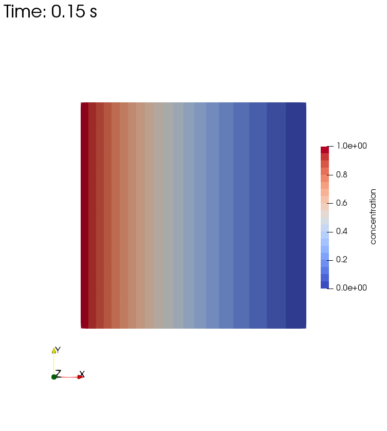

Diffusion only / Diffusion and Storage
Left side boundary conditions for these two setups are pressure $p=0$ and concentration $c=1$. The Diffusion only setup results in the final state of the Diffusion and Storage setup. For the former, retardation is set to $R=0$, while for the latter, $R=1$.

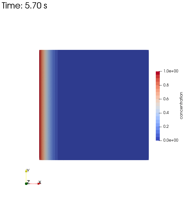

Diffusion, Storage, and Advection
Left side boundary conditions for this setup are pressure $p=1$ and concentration $c=1$.

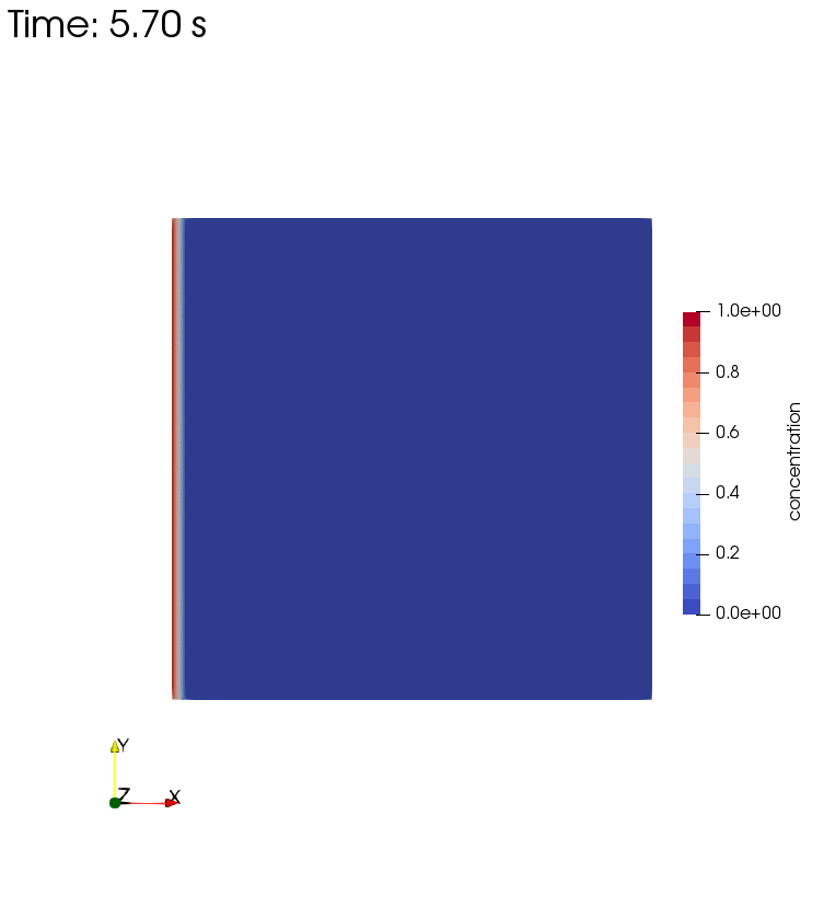

Diffusion, Storage, Advection, and Dispersion
Left side boundary conditions for these setups are pressure $p=1$ and concentration $c=1$. The latter is once given over the full left side, and in a second setup over half of the left side. Longitudinal and transverse dispersivity is $\alpha_l = 1 m$ and $\alpha_t = 0.1 m$.

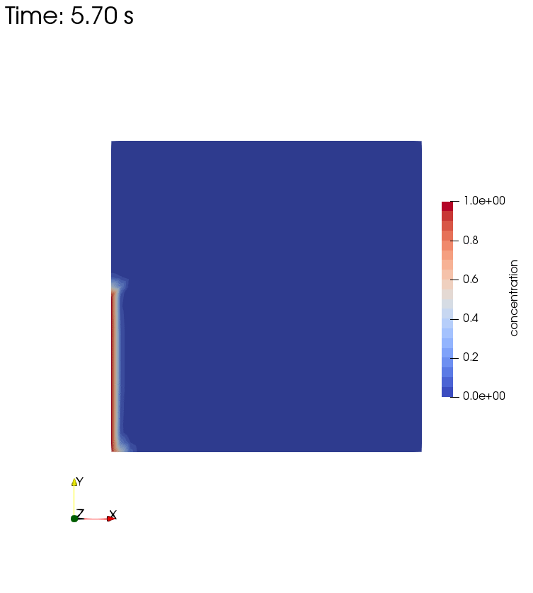

Diffusion, Storage, Advection, and Dispersion Half
Diffusion, Storage, Gravity, and Dispersion
Boundary condition for this setup is pressure $p=0$ for the top left corner and concentration $c=1$ for half of the left side. Relation between concentration and gravity is $\beta_c = 1$.

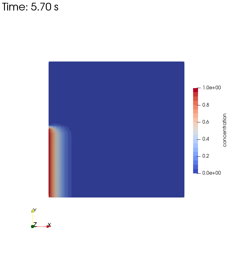

Diffusion, Storage, Gravity, and Dispersion Half
