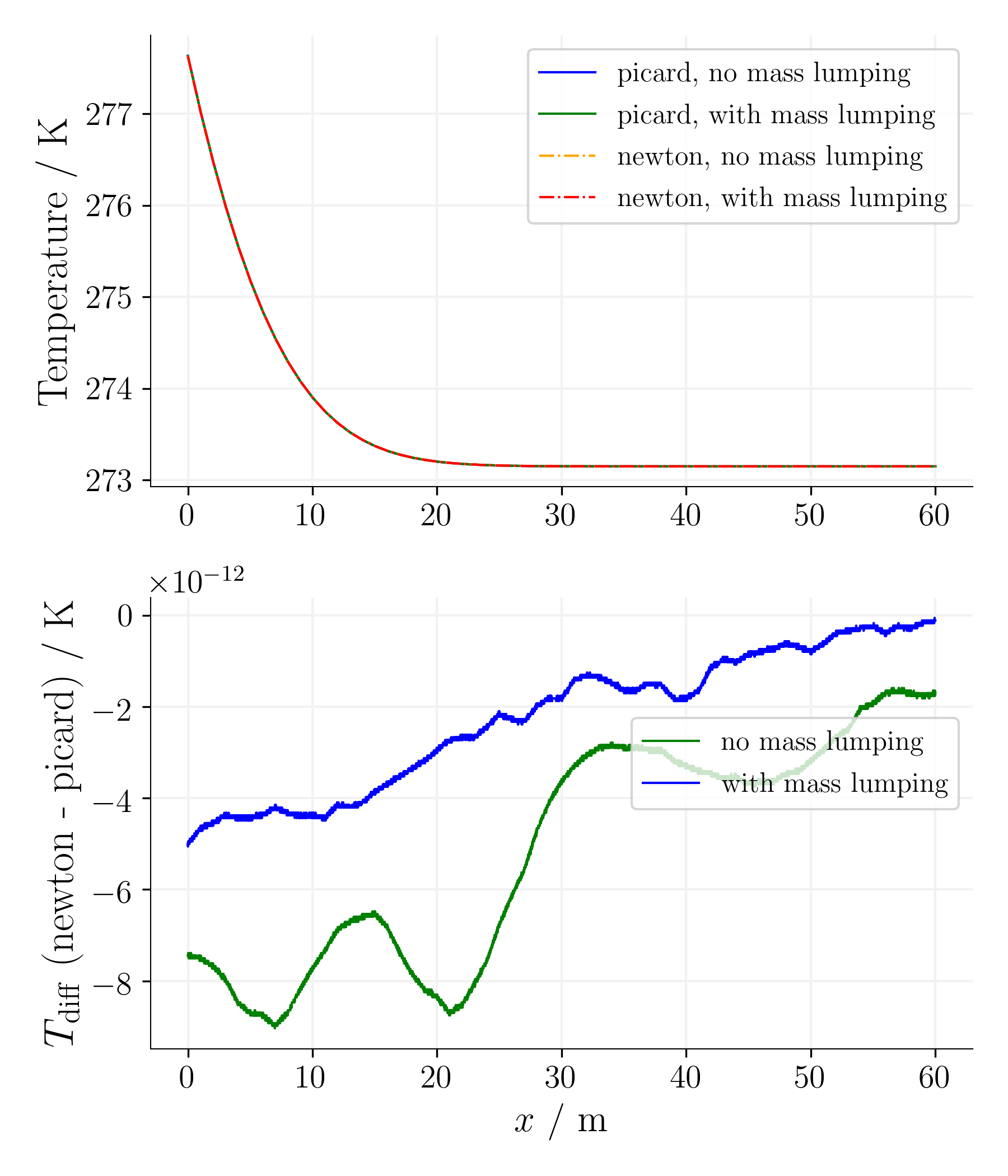

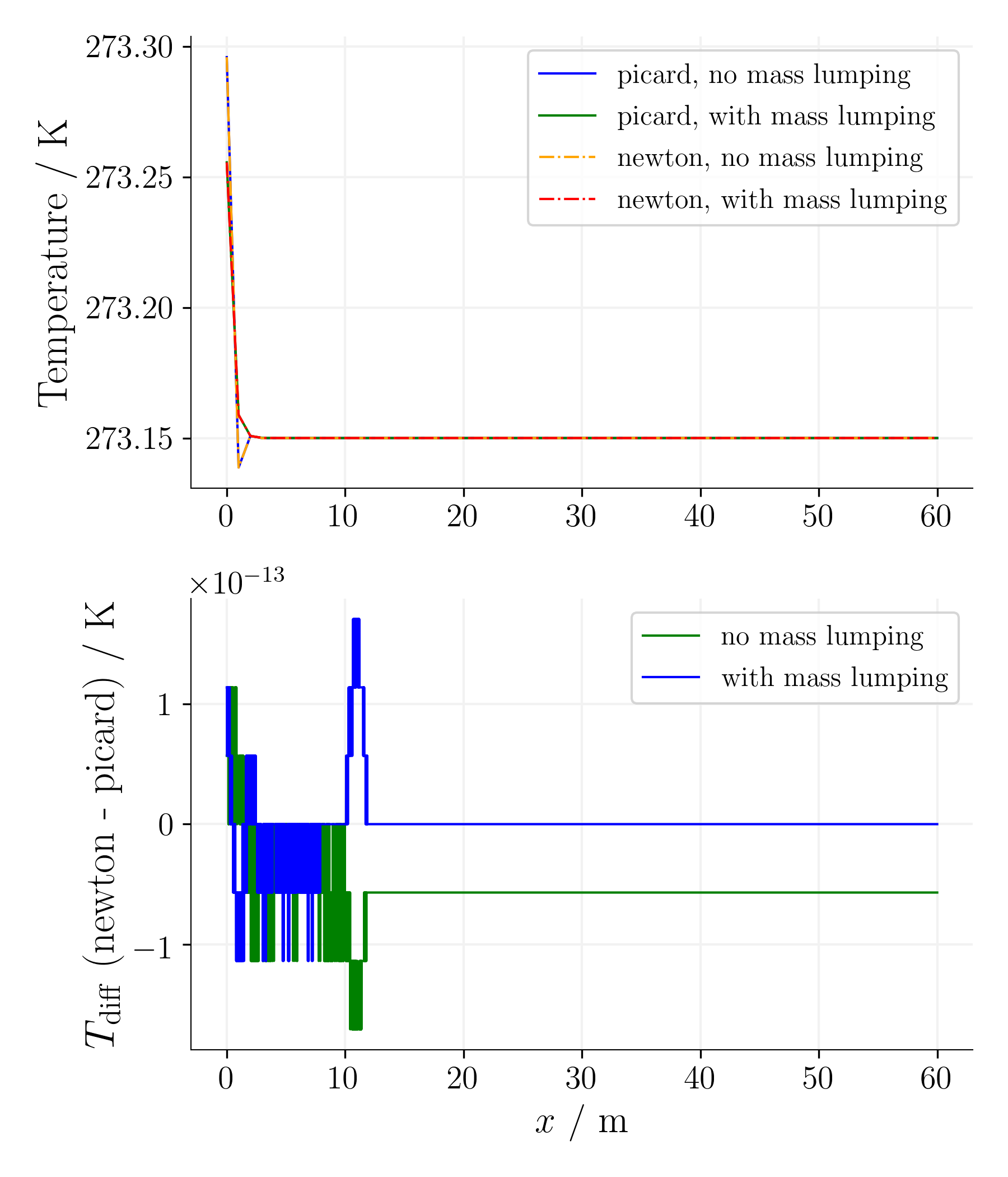

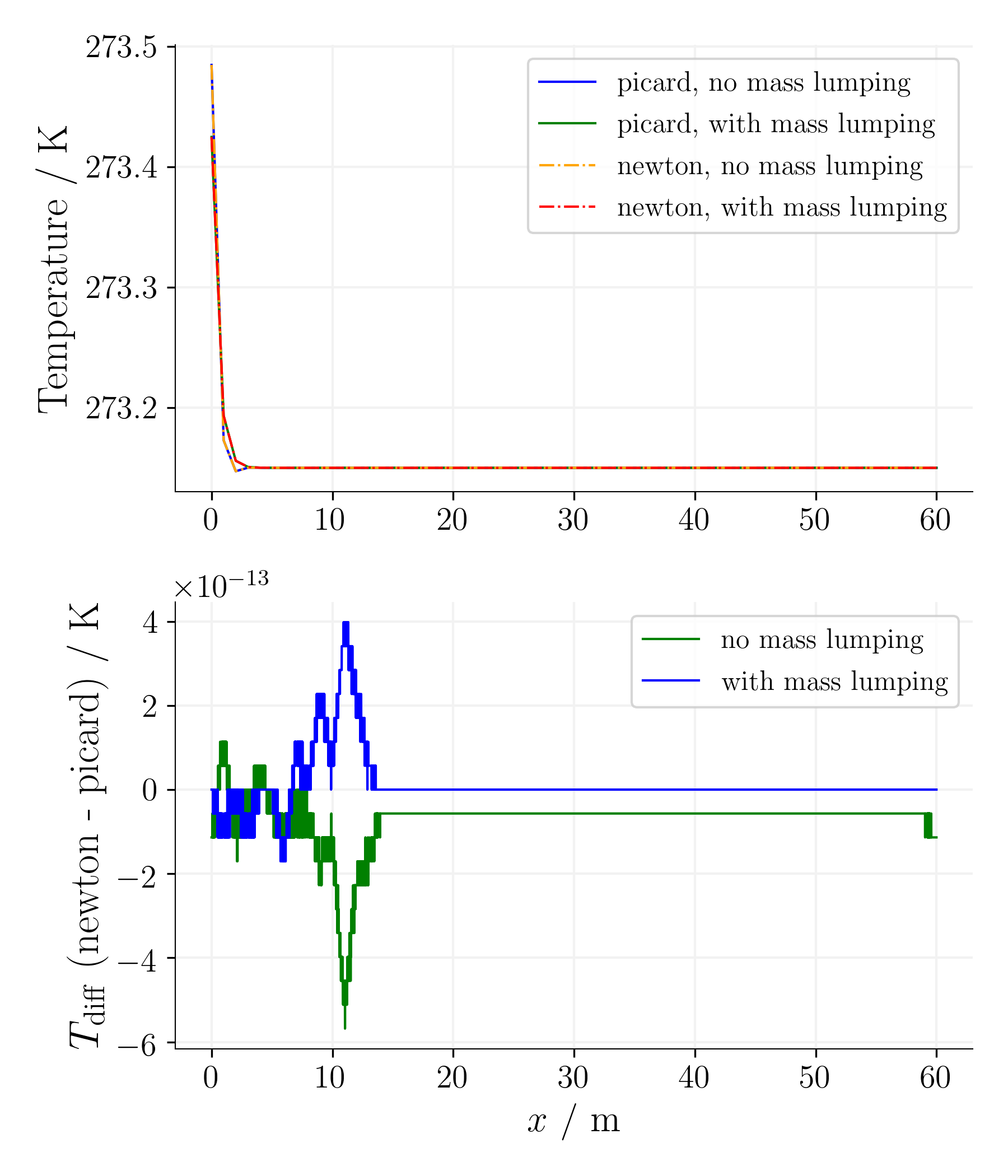

Picard vs. Newton
For the simple equation, as expected, the difference between the Picard and Newton non-linear solvers is reasonable for the given non-linear solver tolerances.
Time step 1, time 78125s.
Time step 3, time 234375s.
Time step 65, time 5078125s.
Time step 405, time 31640625s.

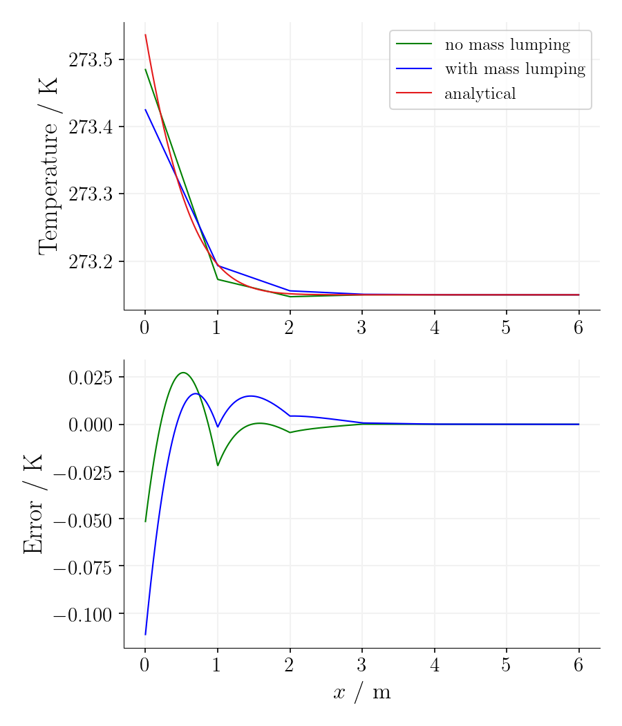

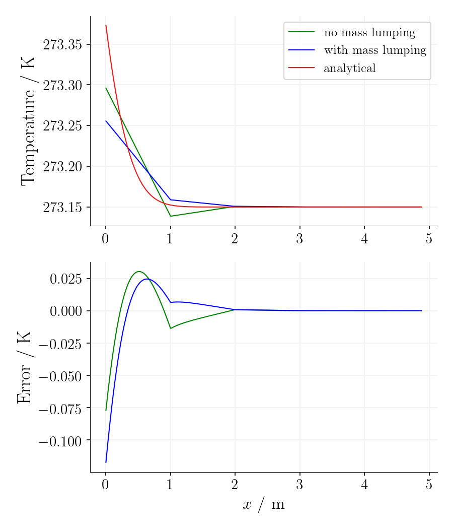

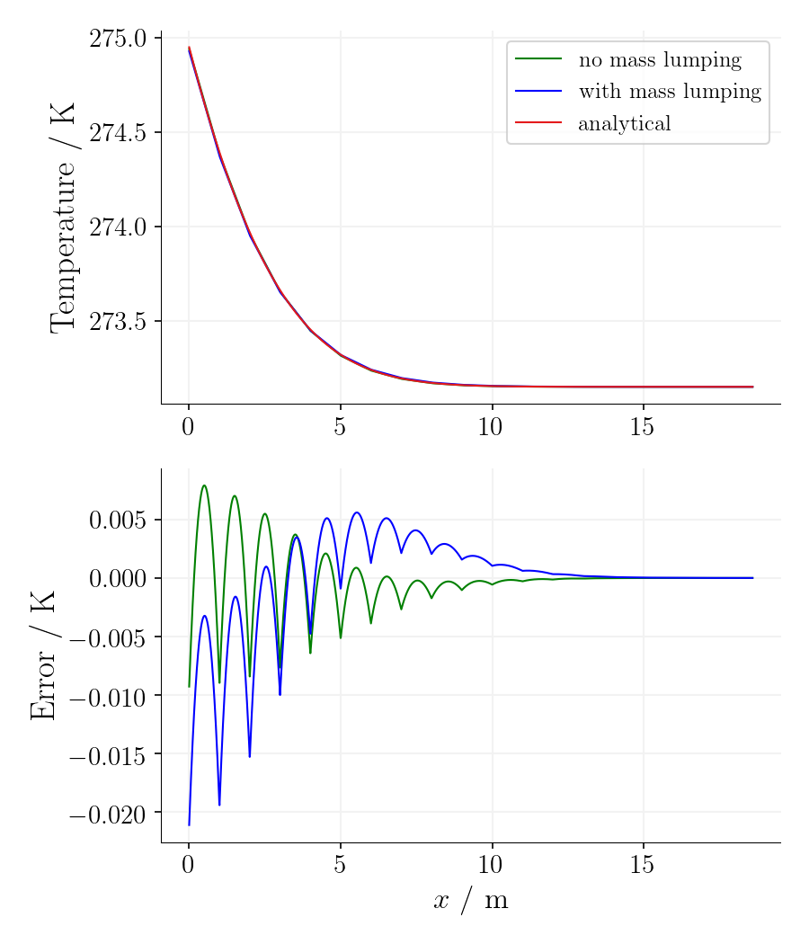

Mass-lumping and analytical solution
Using the mass-lumping method reduces the oscillations for the first time steps on cost of accuracy as the error is significantly larger.
