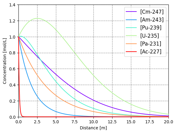

Concentration profiles
c = ana.computeConcentrations(x, t, v, D, k, radionuclides, c_inlet)… (click to toggle)
fig, ax = plt.subplots()
ax.set(xlim=(0, 20), ylim=(0, 1.4))
ax.set(xlabel="Distance [m]", ylabel="Concentration [mol/L]")
color_map = cm.rainbow(np.linspace(0, 1, radionuclides.size))
for radionuclide, color in zip(radionuclides, color_map, strict=True):
    ax.plot(
        x,
        c[radionuclide],
        linestyle="-",
        lw=1.5,
        label=radionuclide,
        c=color,
        zorder=10,
        clip_on=False,
ax.legend(frameon=True, loc="upper right", numpoints=1, fontsize=12, ncol=1)
ax.xaxis.grid(color="gray", linestyle="dashed")
ax.yaxis.grid(color="gray", linestyle="dashed")
Concenctration gradient

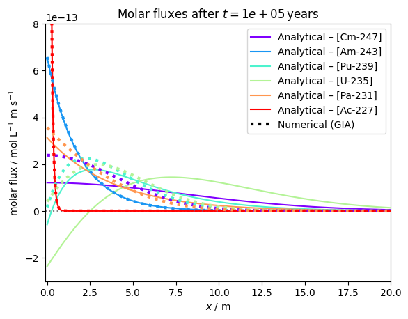

The following graph is just a self-check that the derived analytical expression for the gradient of the analytical solution is correct. The left plot shows both the analytical and numerical (central differences) gradient of the analytical solution for all nuclide concentrations. The center plot shows the difference between analytical and numerical gradients, and the right one the difference normalized to the range in which the numerical gradient varies. This normalized error is smaller than $10^{-6}$ for all nuclides.
color_map = cm.rainbow(np.linspace(0, 1, radionuclides.size))… (click to toggle)
fig, (ax, ax2, ax3) = plt.subplots(1, 3)
for name, color in zip(radionuclides, color_map, strict=True):
    grad_cs = grad_c[name]
    grad_cs_num = grad_c_num[name]
    xs = x_mid
    (h,) = ax.plot(xs, grad_cs, label=name, color=color)
    ax.plot(xs, grad_cs_num, ls=":", color=color, lw=3)
    ax2.plot(xs, grad_cs - grad_cs_num, color=color)
    delta_grad_cs = grad_cs - grad_cs_num
    delta_grad_cs_normalized = delta_grad_cs / (
        np.max(grad_cs_num) - np.min(grad_cs_num)
    ax3.plot(xs, delta_grad_cs_normalized, color=color)
    assert np.max(np.abs(delta_grad_cs)) < 3.5e-6
    assert np.max(np.abs(delta_grad_cs_normalized)) < 9e-7
ax.set_xlabel("$x$ / m")
ax.set_ylabel(r"$\mathrm{grad}\;c$ / mol L$^{-1}$ m$^{-1}$")
ax2.set_xlabel("$x$ / m")
ax2.set_ylabel(r"$\mathrm{grad}\;c$ error / mol L$^{-1}$ m$^{-1}$")
ax3.set_xlabel("$x$ / m")
ax3.set_ylabel(r"normalized $\mathrm{grad}\;c$ error / 1")
ax.set_title(
    rf"$\mathrm{{grad}}\,c$ of the analytical solution at $t = {t:.0g}\,\mathrm{{years}}$"
ax2.set_title(r"Difference between analytical and numerical $\mathrm{grad}\,c$")
ax3.set_title(r"Normalized $\mathrm{grad}\,c$ difference")
ax.set_ylim(-0.5, 0.2)
handles, labels = ax.get_legend_handles_labels()
handles.extend([mpl.lines.Line2D([0], [0], label="numerical", color="k", ls=":", lw=3)])
ax.legend(handles=handles)
fig.set_size_inches(18, 5)
fig.subplots_adjust(wspace=0.25)

Molar fluxes (GIA simulation)
The following graph shows the molar fluxes obtained both analytically (solid lines) and numerically (GIA approach, thick, dotted lines). It can be seen that both results coincide well.
grad_c = ana.computeGradients(x, t, v, D, k, radionuclides, c_inlet)… (click to toggle)
molar_flux_ana = {
    n: -porosity * diffusion_constant * grad_cs for n, grad_cs in grad_c.items()
fig, ax1 = plt.subplots()… (click to toggle)
###Plot subfigure 1###
# ax1.set(xlim=(0, 20), ylim=(-1e-11, 1e-11))
ax1.set(xlabel="$x$ / m", ylabel="molar flux / mol L$^{-1}$ m s$^{-1}$")
# Analytical solution
    ax1.plot(
        x,
        molar_flux_ana[radionuclide],
        linestyle="-",
        lw=1.5,
        label="Analytical – " + radionuclide,
        c=color,
        zorder=10,
        clip_on=True,
# GIA numerical solution
    c_gia = pvdfile_GIA.read_set_data(
        t * 3.1536e7,
        radionuclide + "Flux",
        data_type="point",
        pointsetarray=[(i, 0, 0) for i in x],
    ax1.plot(
        x,
        c_gia,
        # label="GIA - " + radionuclide + "Flux",
        color=color,
        # marker="o",
        # markevery=50,
        linestyle=":",
        linewidth=3,
        zorder=10,
        clip_on=True,
# compute axis limits
ax_min = sys.float_info.max
ax_max = sys.float_info.min
for radionuclide in radionuclides:
    q_min, q_max = np.quantile(molar_flux_ana[radionuclide], [0, 0.95])
    ax_min = min(ax_min, q_min)
    ax_max = max(ax_max, q_max)
ax_range = ax_max - ax_min
# ax1.set_ylim(ax_min - 0.025 * ax_range, ax_max + 0.025 * ax_range)
ax1.set_ylim(-3e-13, 8e-13)
ax1.set_xlim(-0.1, 20)
ax1.axhline(0, ls=":", color="gray")
ax1.set_title(rf"Molar fluxes after $t = {t:.0g}\,\mathrm{{years}}$")
handles, labels = ax1.get_legend_handles_labels()
handles.extend(
    [mpl.lines.Line2D([0], [0], label="Numerical (GIA)", color="k", ls=":", lw=3)]
ax1.legend(handles=handles)
<matplotlib.legend.Legend at 0x7f007bfe4910>

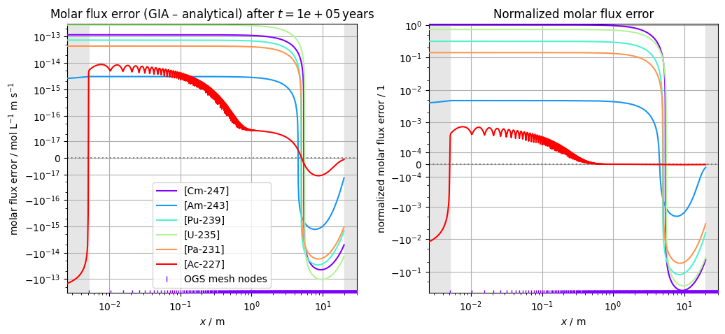

Molar fluxes
The following plots show the difference between numerically computed molar fluxes (OGS, GIA approach) and analytically derived fluxes (left plot), and that difference normalized to the range of analytical concentration gradients (right plot). That normalized error is smaller than 0.1 % for all nuclides.
fig, (ax1, ax2) = plt.subplots(1, 2)… (click to toggle)
fig.set_size_inches(12, 5)
ax1.set(xlabel="$x$ / m", ylabel=r"molar flux error / mol L$^{-1}$ m s$^{-1}$")
check_x_selection = x >= x_mesh[1]
# difference GIA minus analytical
        t * 3.1536e7,
        data_type="point",
    c_ana = molar_flux_ana[radionuclide]
    delta_c = c_gia - c_ana
    ax1.plot(
        x,
        delta_c,
        label=radionuclide,
        color=color,
        # marker=".",
        # markevery=50,
        # linestyle=":",
        # linewidth=3,
        zorder=10,
        clip_on=True,
    c_ana_min = np.min(c_ana)
    c_ana_max = np.max(c_ana)
    c_ana_range = c_ana_max - c_ana_min
    delta_c_normalized = delta_c / c_ana_range
    ax2.plot(
        x,
        delta_c_normalized,
        label=radionuclide,
        color=color,
        # marker=".",
        # markevery=50,
        # linestyle=":",
        # linewidth=3,
        zorder=10,
        clip_on=True,
    # TODO re-enable assert
    # assert np.all(np.abs(delta_c_normalized[check_x_selection]) < 8e-4)
    # compute axis range for ax1
    qmin, qmax = np.quantile(delta_c, [0.05, 1])
    ax_min = min(ax_min, qmin)
    ax_max = max(ax_max, qmax)
# ax_range = ax_max - ax_min
# ax1.set_ylim(-2e-17, 1.1*ax_max)
ax1.set_title(
    rf"Molar flux error (GIA – analytical) after $t = {t:.0g}\,\mathrm{{years}}$"
trans1 = mpl.transforms.blended_transform_factory(ax1.transData, ax1.transAxes)
ax1.plot(
    x_mesh,
    0 * x_mesh,
    scalex=False,
    ls="",
    marker="|",
    color=color_map[0],
    label="OGS mesh nodes",
    zorder=50,
    transform=trans1,
trans2 = mpl.transforms.blended_transform_factory(ax2.transData, ax2.transAxes)
ax2.plot(
    x_mesh,
    0 * x_mesh,
    scalex=False,
    ls="",
    marker="|",
    color=color_map[0],
    zorder=50,
    transform=trans2,
ax1.legend()
ax2.set_title(r"Normalized molar flux error")
ax2.set(xlabel="$x$ / m", ylabel=r"normalized molar flux error / 1")
ax2.axhline(0, ls=":", color="gray")
ax1.set_xscale("log")
ax1.set_xlim(0.5 * x_mesh[1], 1.5 * x[-1])
ax1.axvspan(0.5 * x_mesh[1], x_mesh[1], alpha=1, color="0.9")
ax1.axvspan(x[-1], 1.5 * x[-1], alpha=1, color="0.9")
ax1.set_yscale("asinh", linear_width=5e-18)
ax1.grid()
ax2.set_xscale("log")
ax2.set_xlim(0.5 * x_mesh[1], 1.5 * x[-1])
ax2.axvspan(0.5 * x_mesh[1], x_mesh[1], alpha=1, color="0.9")
ax2.axvspan(x[-1], 1.5 * x[-1], alpha=1, color="0.9")
ax2.set_yscale("asinh", linear_width=1e-4)
ax2.grid()
Molar fluxes are a secondary quantity in OGS. They are computed at the integration points of each mesh element and extrapolated to the mesh nodes for output purposes. The contributions to the nodal values from each adjacent mesh element are averaged. This extrapolation and averaging procedure leads to errors itself. OGS computes an error indicator for the extrapolation and averaging error. This indicator is the root mean square error when re-interpolating the extrapolated and averaged molar fluxes back to the integration points. It is computed as a cell field. It is shown for all nuclides in the plots below. The left plot shows the extrapolation residuals, the right one the extrapolation residuals normalized to the range of molar fluxes. That normalized error is smaller than 0.23 % for all nuclides but Ac-227, for which it is smaller than 1.5 %. The error estimate is larger — in the Ac-227 case much larger — than the actual error. I.e., in this case, it is a conservative estimate of the actual error, but it’s worthwhile to reconsider this on a case-by-case basis.
