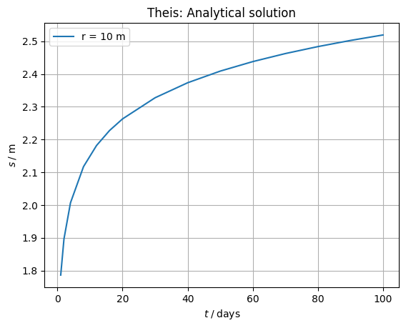

Q = 2000 # Pumping rate from well (m3/day)… (click to toggle)
r = 10  # Distance from well (m)
# Time grid, days.
t = np.array([1, 2, 4, 8, 12, 16, 20, 30, 40, 50, 60, 70, 80, 90, 100])
# Calculate some synthetic data to fit.
S, T = 0.0003, 1000
s = theis_drawdown(t, S, T, Q, r)
# Plot the data
titlestring = "Theis: Analytical solution"
plt.title(titlestring)
plt.plot(t, s, label="r = " + str(r) + " m")
plt.xlabel(r"$t\;/\;\mathrm{days}$")
plt.ylabel(r"$s\;/\;\mathrm{m}$")
plt.legend()
plt.grid()

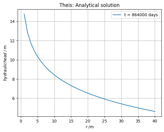

# Recalculation from days in sec… (click to toggle)
Q = 0.016  # Pumping rate from well (m3/s)
t = 864000  # Time in s.
##r = np.array([0.5, 1, 2, 4, 8, 12, 16, 20, 25, 30, 35, 40])
r = np.arange(1, 41, 1)
##print(r)
S = 0.001
T = 9.2903e-4
u = calc_u(r, S, T, t)
s = s - 5  # reference head
# Plot the data
plt.plot(r, s, label="t = " + str(t) + " days")
plt.xlabel(r"$r\;/\mathrm{m}$")
plt.ylabel(r"$hydraulic head\;/\;\mathrm{m}$")
plt.legend()
plt.grid()

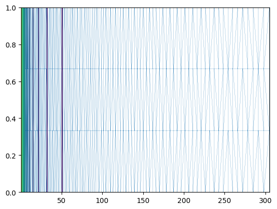

print("inspecting mesh and initial conditions")… (click to toggle)
# file
reader = vtk.vtkXMLUnstructuredGridReader()
reader.SetFileName(vtu_name)
reader.Update()  # Needed because of GetScalarRange
data = reader.GetOutput()
pressure = data.GetPointData().GetArray("OGS5_pressure")
# points
points = data.GetPoints()
npts = points.GetNumberOfPoints()
x = vtk_to_numpy(points.GetData())
triang = tri.Triangulation(x[:, 0], x[:, 1])
# plt.triplot(triang, 'go-', lw=1.0)
plt.triplot(triang, lw=0.2)
plt.tricontour(triang, pressure, 16)
<matplotlib.tri._tricontour.TriContourSet at 0x7fdf240696a0>

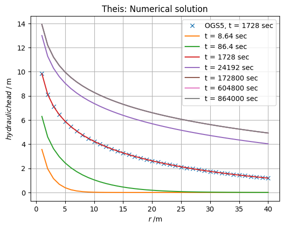

Spatial Profiles
# Read simulation results… (click to toggle)
pvdfile = vtuIO.PVDIO(f"{out_dir}/{pvd_name}.pvd", dim=2)
xaxis = [(i, 0, 0) for i in np.linspace(start=1.0, stop=40, num=40)]
r_x = np.array(xaxis)[:, 0]
time = [8.64, 86.4, 1728, 24192, 172800, 604800, 864000]
pressure_xaxis_t = pvdfile.read_set_data(
    t, "OGS5_pressure", data_type="point", pointsetarray=xaxis
plt.plot(r_x, pressure_xaxis_t, "x", label="OGS5, t = 1728 sec")
for t in time:
        t, "pressure", data_type="point", pointsetarray=xaxis
    plt.plot(r_x, pressure_xaxis_t, label="t = " + str(t) + " sec")
titlestring = "Theis: Numerical solution"
plt.legend()
plt.grid()
# plt.savefig("theis.png")

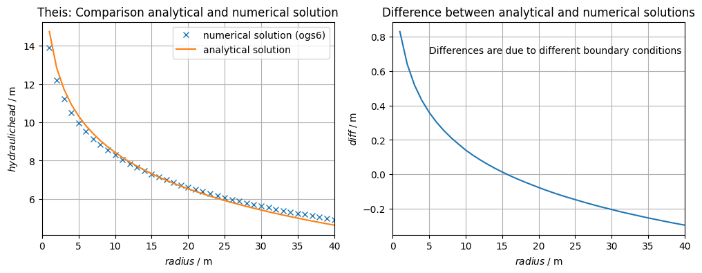

time = [864000]… (click to toggle)
time = [864000]
# plot configuration
##plt.rcParams['figure.figsize'] = (16, 6)
##plt.rcParams['font.size'] = 12
##fig1, (ax1, ax2) = plt.subplots(1, 2)
fig, ax = plt.subplots(ncols=2, figsize=(12, 4))
titlestring = "Theis: Comparison analytical and numerical solution"
ax[0].set_title(titlestring)
ax[0].set_xlim(0, 40)
ax[0].plot(r_x, pressure_xaxis_t, "x", label="numerical solution (ogs6)")
ax[0].plot(r, s, label="analytical solution")
ax[0].set_xlabel(r"$radius\;/\;\mathrm{m}$")
ax[0].set_ylabel(r"$hydraulic head\;/\;\mathrm{m}$")
ax[0].grid()
ax[0].legend()
##diff = np.setdiff1d(s,pressure_xaxis_t,assume_unique=False)
##print(diff)
titlestring = "Difference between analytical and numerical solutions"
caption = "Differences are due to different boundary conditions"
ax[1].set_title(titlestring)
ax[1].set_xlim(0, 40)
ax[1].plot(r, s - pressure_xaxis_t, label="")
ax[1].set_xlabel(r"$radius\;/\;\mathrm{m}$")
ax[1].set_ylabel(r"$diff\;/\;\mathrm{m}$")
ax[1].grid()
ax[1].text(5, 0.7, caption, ha="left")
##plt.savefig("theis-ana+num.png")
