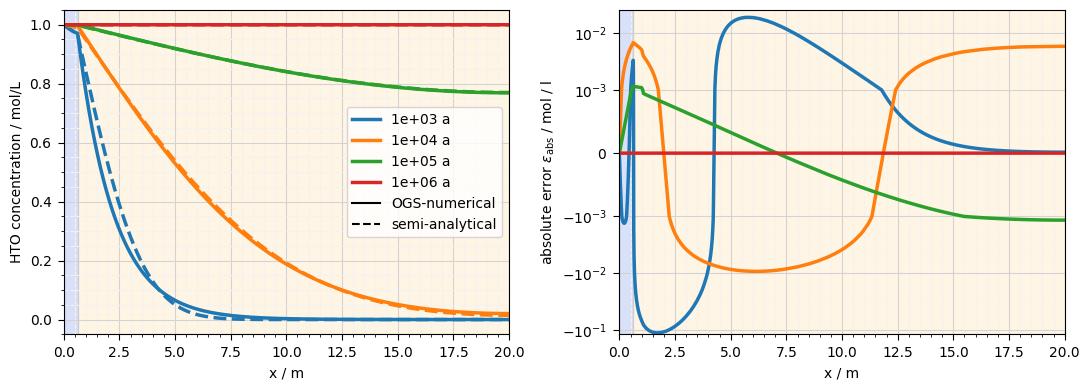

In waste repositories, radionuclide release can be expected after rupture of waste canisters to occur in the engineered barrier system, which contains multiple layers of materials and host rocks. In this benchamrk, a tracer (HTO) diffusion process through a two-layer barrier is simulated. The barrier is comprised of a bentonite buffer layer and an opalinus clay (OPA) layer.
Over the one-dimensional model domain, the diffusion process of HTO can be described with the following governing equation:
$$ \frac{\partial \left( \phi c\right)}{\partial t} = \frac{\partial}{\partial x} \left( \phi \mathrm{D_p} \frac{\partial c}{\partial x} \right), $$
where $c$ [mol/m$^3$] represents the HTO concentration. $\mathrm{D_p}$ [m$^2$/s] is the pore diffusion coefficient for HTO, and $\phi$ [-] is the porosity of the media.
Model setups
The computational domain is assumed to be 20 meters long. It consists of a 0.625 meter thick layer of bentonite buffer, and the rest is filled with OPA. The simulation time is one million years. Initially, the entire domain is assumed to be solute free, i.e. $c_{\mathrm{ini}}(x, 0) = 0$. The inlet concentration is held at 1 mol/L throughout the simulation, i.e. $c(0, t) = 1$ mol/L. In the numerical model, the spatial domain is discretized by linear line elements with a length of 0.005 meter each. The time step size of 1000 years is used in the simulation. The discretized governing equation is iteratively solved using the Newton-Raphson method.
Parameter Value Unit
Porosity of bentonite $\phi_{\mathrm{b}}$ 0.36 -
Porosity of OPA $\phi_{\mathrm{OPA}}$ 0.12 -
Pore diffusion coefficient in bentonite $\mathrm{D_{p,b}}$ 5.55e-10 m$^2$/s
Pore diffusion coefficient in OPA $\mathrm{D_{p,OPA}}$ 8.33e-11 m$^2$/s
Grid size $\Delta x$ 0.01 m
For a two-layer diffusion problem, it is difficult to obtain the exact analytical solution. Instead, Carr and Turner (2016) presented a semi-analytical solution for this type of problem and released the corresponding MATLAB script for public usage.
Here we provide a MATLAB script through which we can compute the concentration profiles along the two-layer domain. The following figure illustrates the concentration profiles at $t$ = 10$^3$, 10$^4$, 10$^5$, and 10$^6$ years (see calculated values in SemiAnalyticalSolutionResults.csv).

Numerical solution
Correspondingly, the OGS input files of this 1D mass transport benchmark can be found here.
Then, the numerical solution by OpenGeoSys is plotted against the semi-analytical solution for comparison.
# Run OGS simulation… (click to toggle)
name = "1D_MultiLayerDiffusion"
Simulation: /var/lib/gitlab-runner/builds/vZ6vnZiU/0/ogs/build/release-all/Tests/Data/Parabolic/ComponentTransport/MultiLayerDiffusion/MultiLayerDiffusion/1D_MultiLayerDiffusion_modified.prj
Execution took 34.37271308898926 s
ms_MLD = ot.MeshSeries(out_dir / f"{name}.pvd").scale(time=("s", "a"))[1:]… (click to toggle)
HTO_var = ot.variables.Scalar("HTO", "mol/L", "mol/L", "HTO concentration")
fig = plot_results(ms_MLD, HTO_var)
In the first time step, the semi-analytical and numerical solutions do not agree so well. As the time step progresses, they begin to agree more closely.

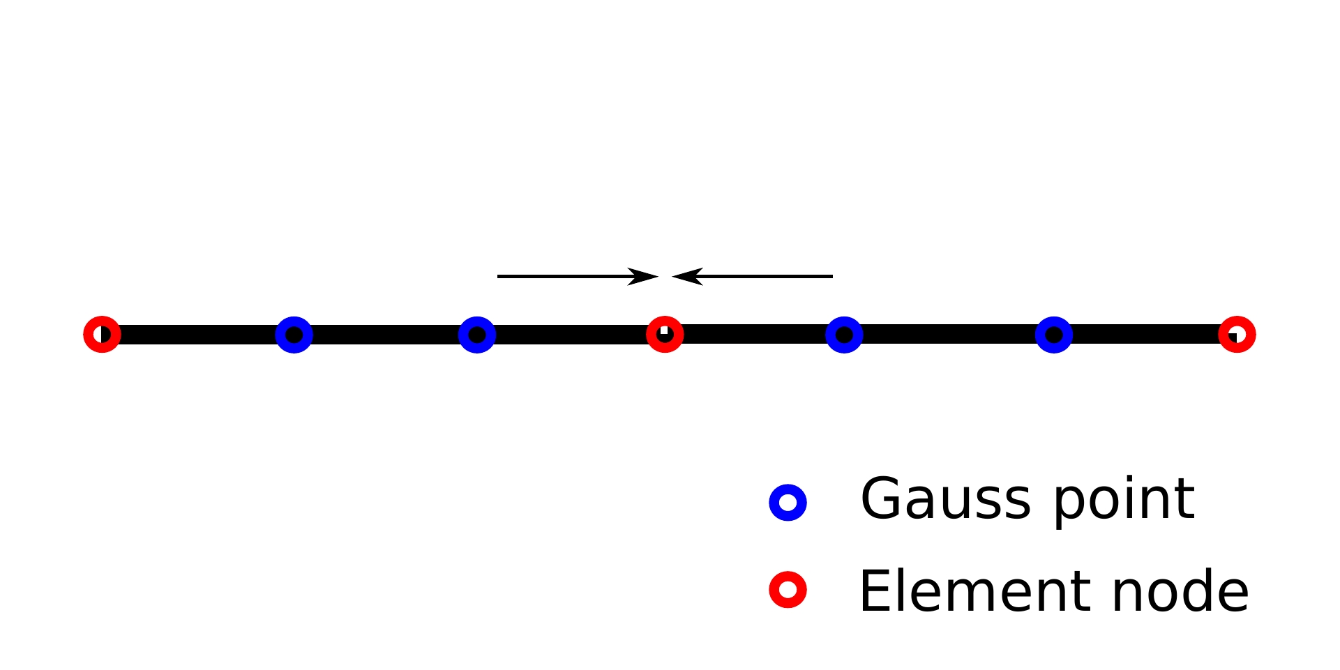

Mass flux calculation
Here is a sketch that shows how we calculate the molar flux at the node.
display(Image(filename="./sketch_molar_flux_calculation.jpg", width=100))
jpeg

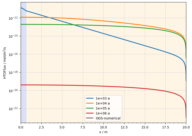

Additionally, we compute the molar flux profiles at $t$ = 10$^3$, 10$^4$, 10$^5$, and 10$^6$ years. The implementation of molar flux output can be viewed at this link.
HTO_flux_var = ot.variables.Scalar("HTOFlux", "mol/m$^2$/s")… (click to toggle)
fig = plot_results(ms_MLD, HTO_flux_var)
fig.axes[0].set_yscale("log")
