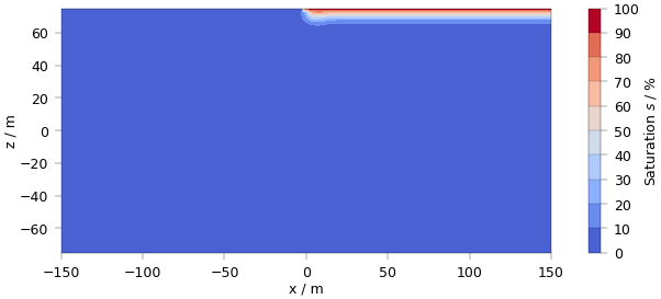

The concentration and pressure at the beginning of the simulation are shown in the figures below.
fig_t0_si = ot.plot.contourf(mesh_t0, ot.variables.saturation, vmin=0)
fig_t0_p = ot.plot.contourf(mesh_t0, ot.variables.pressure)

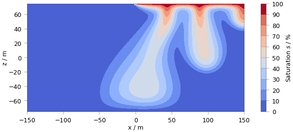

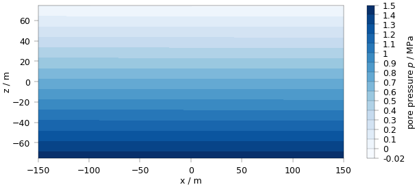

The concentration and pressure at the end of the simulation are shown in the figures below.
fig_tend_si = ot.plot.contourf(mesh_tend, ot.variables.saturation, vmin=0)
fig_tend_p = ot.plot.contourf(mesh_tend, ot.variables.pressure)
