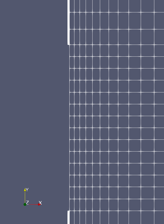

Consider a heat source defined as boundary in following mesh:
| The “dent” in the right side of the mesh is a 2D, rectangular source |
With height alongside Y-axis defined as $h=8$ meters and width alongside X-axis as $r=0.095$ meters. Since the boundary parallel to Y-axis is axially symmetrical, the two dimensional rectangle will turn into a three dimensional cylinder after the mesh has been rotated by $360°$ with Y-axis boundary as rotation axis.
