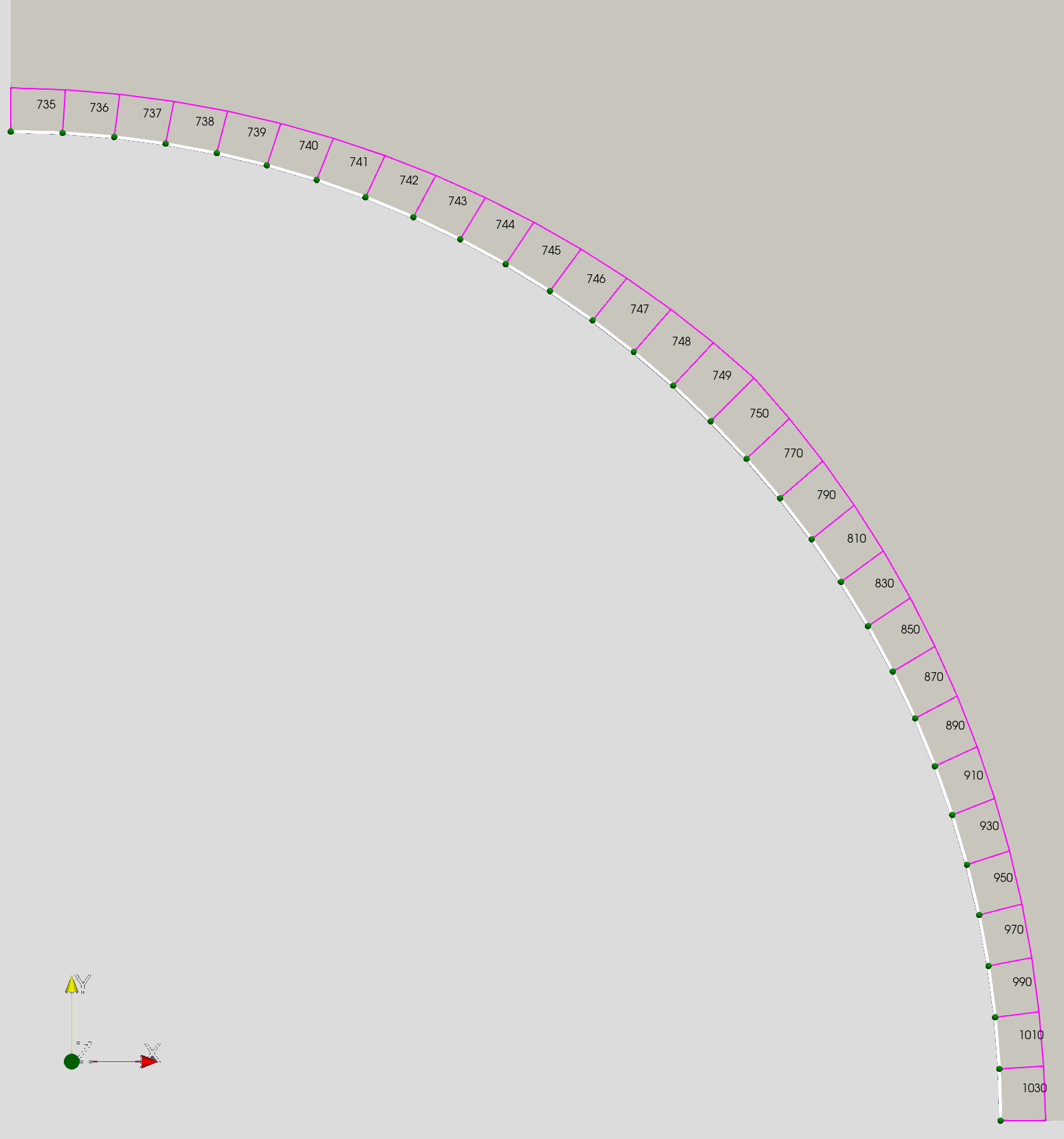

Given a “bulk” mesh (Tests/Data/Mechanics/Linear/disc_with_hole.vtu) and a
quarter circle mesh extracted manually we want to use the
quarter circle mesh for heterogeneous boundary condition. OGS requires two
mappings into the “bulk” mesh, one for the nodes and one for the elements.
To create these mappings we run
identifySubdomains -m Tests/Data/Mechanics/Linear/disc_with_hole.vtu -s 1e-6 -o
new_ -- quater_circle.vtu
The tool will first try to find all unique nodes in the “bulk” mesh using search
radius 1e-6, and create the bulk_node_ids mapping upon success. Then the
bulk_element_ids mapping is created by finding a unique element containing all
the nodes of the subdomain element. The output file
new_quater_circle.vtu will now contain both
mappings and is prepared for usage as a boundary condition mesh.
