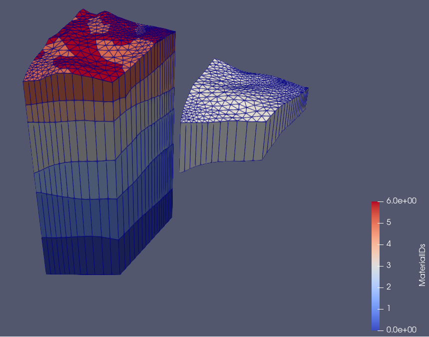

In this example we use a 3D mesh (Fig.1) and extract its elements of material ID 3 to create a new mesh.
ExtractMaterials -i mesh_layered.vtu -o mesh_exMatId.vtu -m 3
Fig.1 The left side shows a layered 3D input mesh created from raster files using the tool createLayeredMeshFromRasters. The different colors depict different material IDs. The z-values of the meshes are scaled by a factor of 10. The right mesh shows the extracted mesh. In this graphic it is translated along the x-axis, its spatial coordinates are not altered by the ExtractMaterials-tool.
