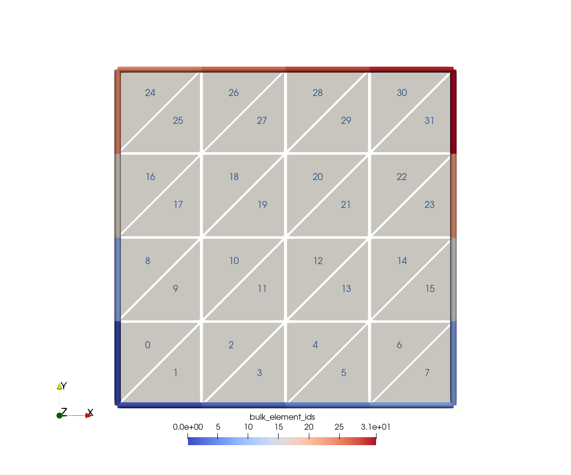

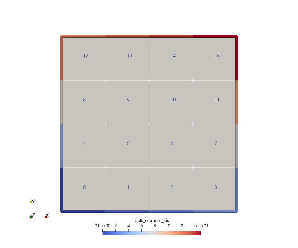

ExtractBoundary -i square_1x1_quad.vtu -o square_1x1_quad_border.vtu
ExtractBoundary -i square_1x1_tri.vtu -o square_1x1_tri_border.vtu
