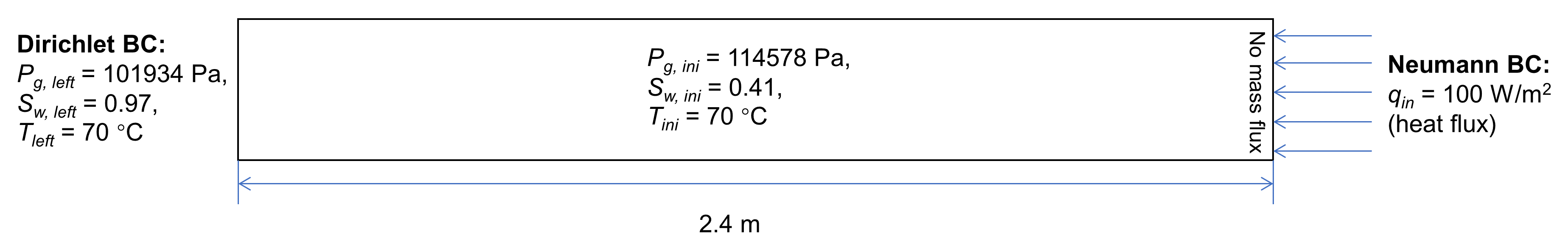

Physical Scenario
As shown in the below figure, the heat pipe was represented by a 2D horizontal column (2.4 m in length and 0.2 m in width) of porous media, which was partially saturated with a liquid phase ($S_w$ = 0.41) at the beginning. A heater is installed on the right-hand-side of the horizontal column generating a constant heat flux of 100 $\mathrm{W/m^2}$ and raises the temperature gradually above the boiling point. At the left-hand boundary, we impose the constant gas phase pressure ($P_g$ = 101934 Pa), constant liquid saturation ($S_w$ = 0.97) and constant temperature ($T = 343 K = 70 ^\circ C$) as Dirichlet boundary conditions.
Model domain

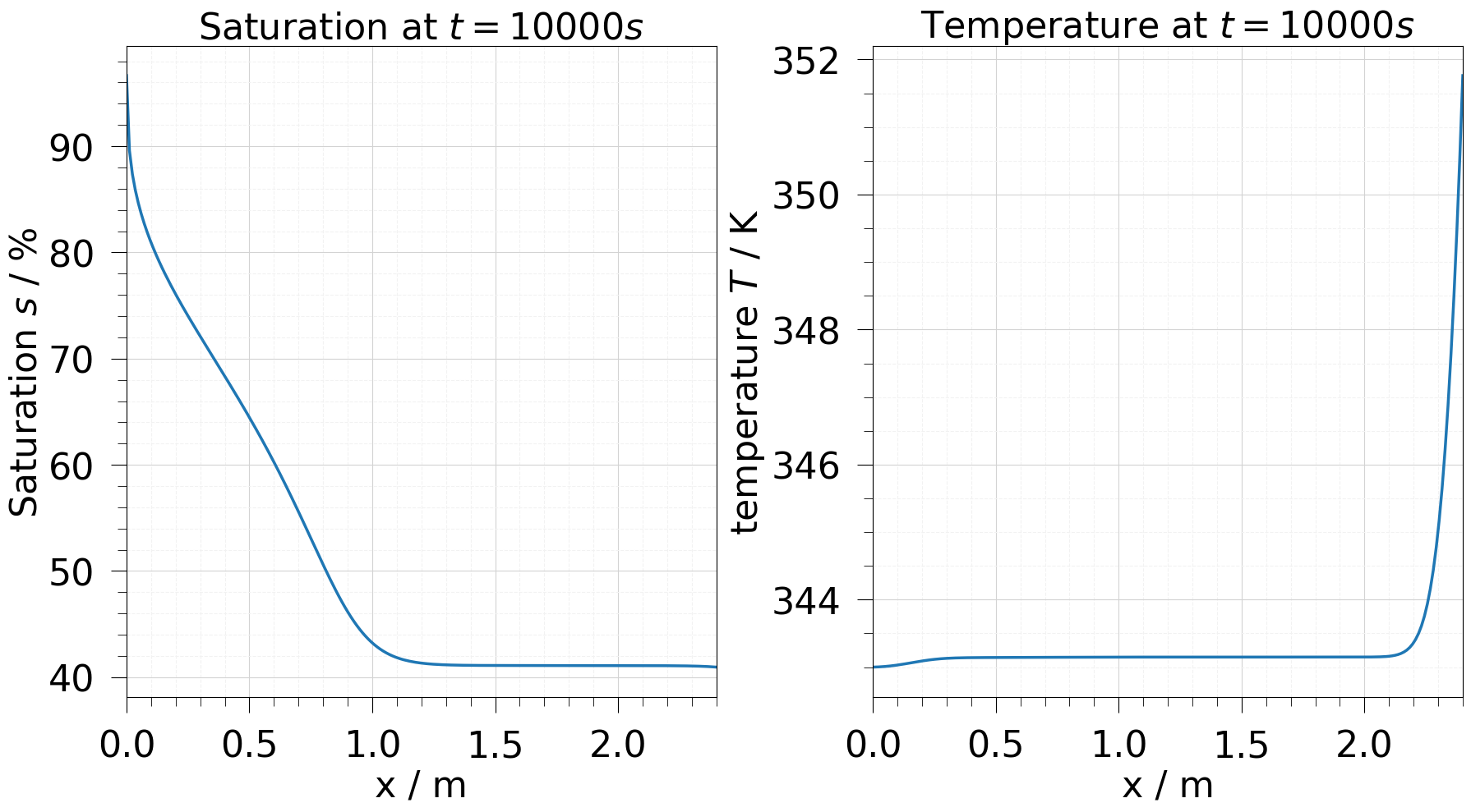

In the CTEST-small, the comparison is made for the time of 10000 seconds. The profiles of saturation and temperature are plotted below.
probe_points = np.column_stack(… (click to toggle)
    (np.arange(0, 0.012 * 201, 0.012), np.full(201, 0.1), np.zeros(201))
ms = ot.MeshSeries("ref_t_10000.000000.vtu")
ms_saturation = ot.MeshSeries.probe(
    ms, probe_points, saturation.replace(output_unit="")
ms_temperature = ot.MeshSeries.probe(ms, probe_points, temperature)
fig, ax = plt.subplots(figsize=(18, 10), ncols=2)
ot.plot.line(ms_saturation, saturation, ax=ax[0])
ot.plot.line(ms_temperature, temperature, ax=ax[1])
ax[0].set_title("Saturation at $t = 10000s$")
ax[1].set_title("Temperature at $t = 10000s$")
_ = [a.set_xlim(0, 2.4) for a in ax]

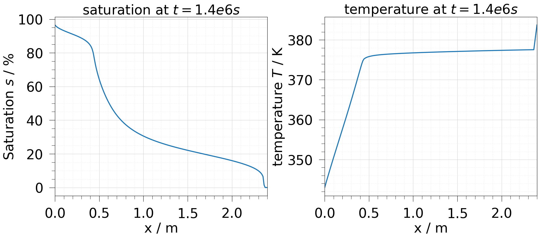

In the CTEST-large, the comparison is made for the time of 1.4e6 seconds. Around this time, the water is fully evaporated from the heating boundary (right hand side), and single phase zone of gas phase is formulated, while the temperature at this part begins to increase significantly, as shown below.
ms = ot.MeshSeries("ref_t_1400000.000000.vtu")… (click to toggle)
fig, ax = plt.subplots(figsize=(18, 8), ncols=2)
ax[0].set_title("saturation at $t = 1.4e6s$")
ax[1].set_title("temperature at $t = 1.4e6s$")

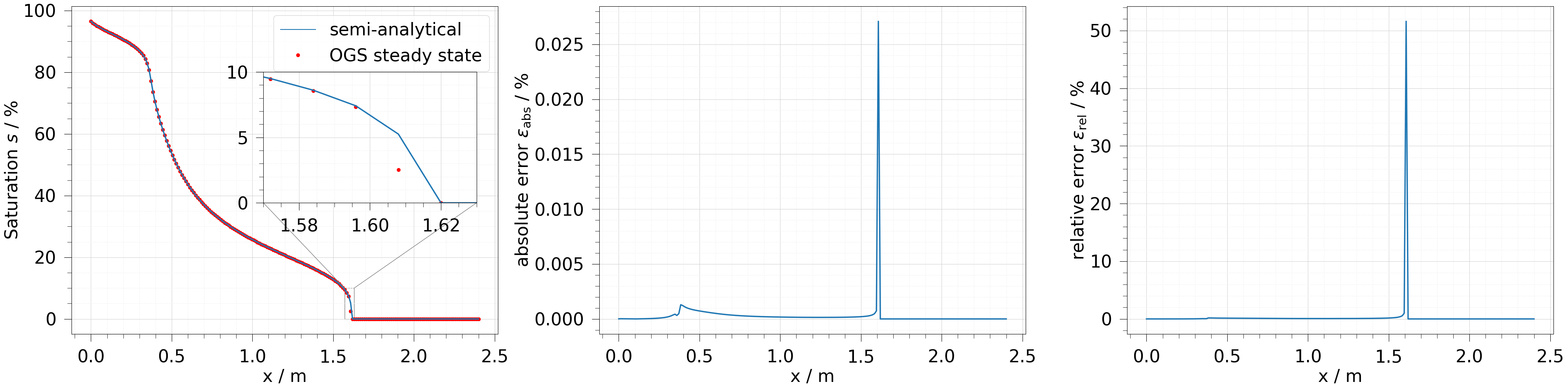

For the steady-state solution of this problem, a semi-analytical solution was derived by Udell and Fitch (1985) and extended by Huang et al. (2015). Here we provide the semi-analytical solution as a MATLAB script which enables us to compute the steady-state gas pressure, saturation and temperature profiles along the $x$-direction (see calculated values in SemianalyticalSolutionResults.csv). In the following, the numerical solution by OpenGeoSys at quasi-steady state ($t$ = 2e7 s) is plotted against the semi-analytical solution for comparison. In addition, the absolute and relative errors are also illustrated.
semi_ana_solution = pd.read_csv(… (click to toggle)
    "SemianalyticalSolutionResults.csv",
    sep=",",
    header=None,
    skiprows=0,
    names=["x", "saturation", "temperature", "pressure"],
    index_col=False,
results = ot.MeshSeries("ref_steady_status.vtu")
results_saturation = ot.MeshSeries.probe(… (click to toggle)
    results, probe_points, saturation.replace(output_unit="")
mask = semi_ana_solution["saturation"] != 0
abs_error = np.abs(
    semi_ana_solution["saturation"] - results_saturation.point_data[saturation][0]
rel_error = np.zeros_like(semi_ana_solution["saturation"])
rel_error[mask] = np.abs(abs_error[mask] / (semi_ana_solution["saturation"][mask]))
np.testing.assert_array_less(abs_error, 6)
np.testing.assert_array_less(rel_error, 0.6)
results_saturation.point_data[saturation.anasol.data_name] = semi_ana_solution[
    "saturation"
results_saturation.point_data[saturation.abs_error.data_name] = abs_error
results_saturation.point_data[saturation.rel_error.data_name] = rel_error
%%capture --no-display… (click to toggle)
fig, ax = plt.subplots(ncols=3, figsize=(40, 10))
ax[0].plot([], [], color="C0", label="semi-analytical")
ot.plot.line(
    results_saturation,
    saturation,
    ax=ax[0],
    marker="o",
    linestyle="",
    color="red",
    label="OGS steady state",
ot.plot.line(results_saturation, saturation.anasol, ax=ax[0])
ot.plot.line(results_saturation, saturation.abs_error, ax=ax[1])
ot.plot.line(results_saturation, saturation.rel_error, ax=ax[2])
ax_inset = inset_axes(
    ax[0],
    width="100%",
    height="100%",
    loc="center",
    bbox_to_anchor=[0.45, 0.4, 0.5, 0.4],
    bbox_transform=ax[0].transAxes,
ot.plot.line(
    results_saturation, saturation, ax=ax_inset, marker="o", linestyle="", color="red"
ot.plot.line(results_saturation, saturation.anasol, ax=ax_inset)
ax_inset.set(xlim=(1.57, 1.63), ylim=(0, 10), xlabel="", ylabel="")
patch, pp1, pp2 = mark_inset(ax[0], ax_inset, loc1=3, loc2=4, fc="none", ec="0.5")
pp1.loc2, pp2.loc2 = 2, 1

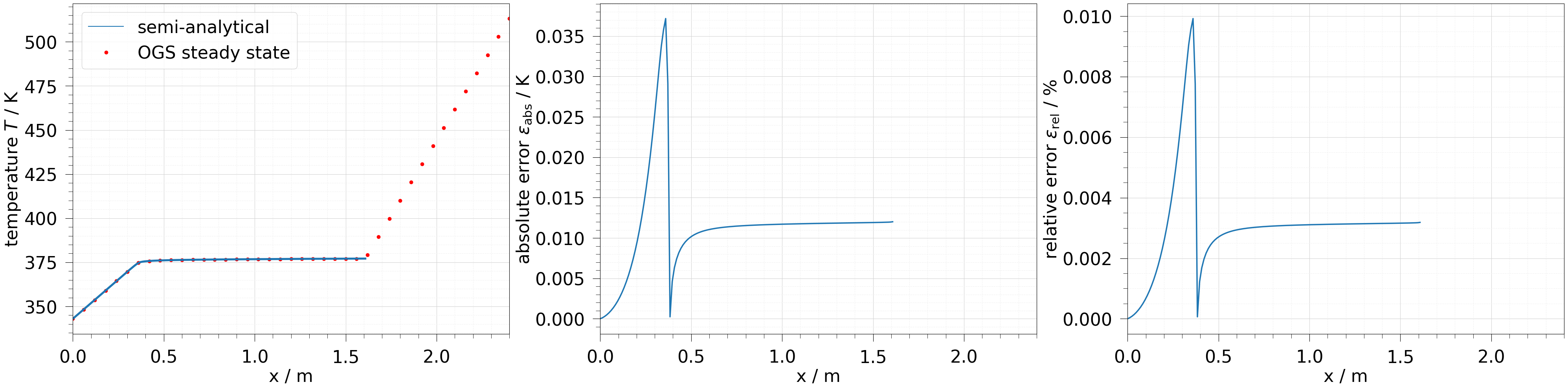

results_temperature = ot.MeshSeries.probe(results, probe_points, temperature)… (click to toggle)
abs_error = np.abs(
    semi_ana_solution["temperature"] - results_temperature.point_data[temperature][0]
mask = np.isnan(semi_ana_solution["temperature"])
rel_error = np.abs(abs_error / (semi_ana_solution["temperature"]))
np.testing.assert_array_less(abs_error[~mask], 0.04)
np.testing.assert_array_less(rel_error[~mask], 0.01)
results_temperature.point_data[temperature.anasol.data_name] = semi_ana_solution[
    "temperature"
results_temperature.point_data[temperature.abs_error.data_name] = abs_error
results_temperature.point_data[temperature.rel_error.data_name] = rel_error
fig, ax = plt.subplots(ncols=3, figsize=(40, 10))… (click to toggle)
ax[0].plot([], [], color="C0", linewidth=1.5, label="semi-analytical")
ot.plot.line(
    results_temperature,
    temperature,
    ax=ax[0],
    marker="o",
    markersize=6,
    markevery=5,
    linestyle="",
    color="red",
ot.plot.line(results_temperature, temperature.anasol, ax=ax[0], linewidth=1.5)
ot.plot.line(results_temperature, temperature.abs_error, ax=ax[1])
ot.plot.line(results_temperature, temperature.rel_error, ax=ax[2])

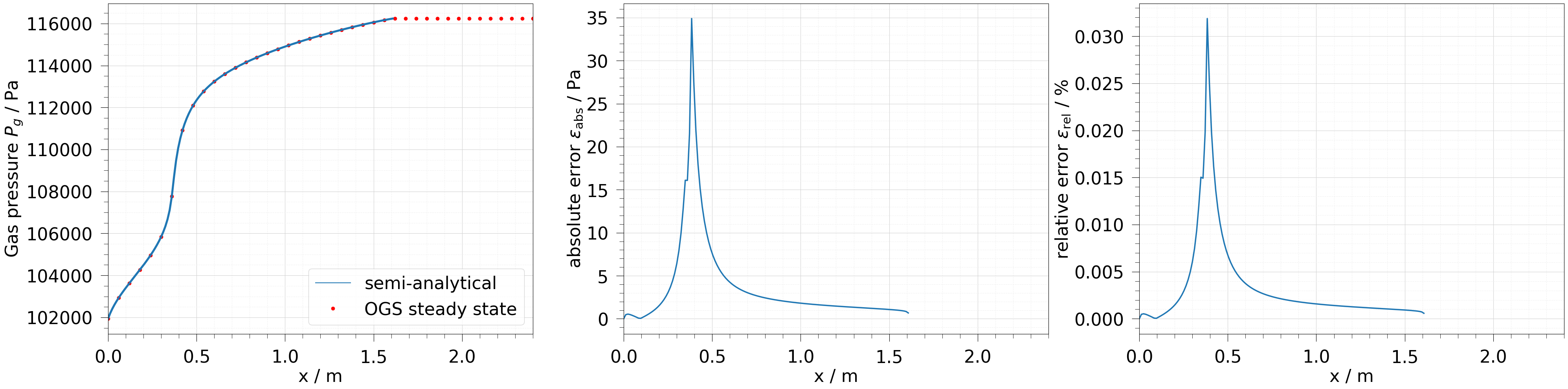

results_pressure = ot.MeshSeries.probe(results, probe_points, pressure)… (click to toggle)
abs_error = np.abs(
    semi_ana_solution["pressure"] - results_pressure.point_data[pressure][0]
rel_error = np.zeros_like(semi_ana_solution["pressure"])
rel_error = np.abs(abs_error / (semi_ana_solution["pressure"]))
results_pressure.point_data[pressure.anasol.data_name] = semi_ana_solution["pressure"]
results_pressure.point_data[pressure.abs_error.data_name] = abs_error
results_pressure.point_data[pressure.rel_error.data_name] = rel_error
ot.plot.line(
    results_pressure,
    pressure,
    ax=ax[0],
    marker="o",
    markevery=5,
    linestyle="",
    color="red",
ot.plot.line(results_pressure, pressure.anasol, ax=ax[0], linewidth=1.5)
ot.plot.line(results_pressure, pressure.abs_error, ax=ax[1])
ot.plot.line(results_pressure, pressure.rel_error, ax=ax[2])

From the above results, it can be seen that a very good agreement is obtained with respect to the variables saturation, temperature and gas pressure, especially for the latter two. For the saturation, there is only one data point that the divergence between numerical and semi-analytical solutions is obvious, which situates at the end of the two-phase zone (see the embedded subplot above). This might be due to the sharp saturation change around this point which necessitates further mesh refinement locally. Nevertheless, the extent of the heat pipe region at steady state was modeled accurately. The disappearance of the water phase associated with a change of the phase state was carried out well. Note that the OGS solution allows a region near the heated boundary to completely dry out, thus creating increased temperatures (superheated steam) in comparison to the semi-analytical results which assumes coexistence of the liquid and gas phases.
