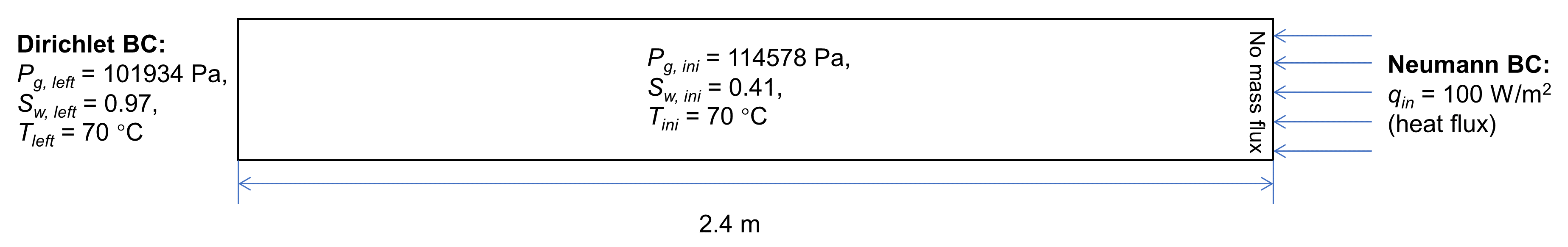

Physical Scenario
As shown in the below figure, the heat pipe was represented by a 2D horizontal column (2.4 m in length and 0.2 m in width) of porous media, which was partially saturated with a liquid phase ($S_w$ = 0.41) at the beginning. A heater is installed on the right-hand-side of the horizontal column generating a constant heat flux of 100 $\mathrm{W/m^2}$ and raises the temperature gradually above the boiling point. At the left-hand boundary, we impose the constant gas phase pressure ($P_g$ = 101934 Pa), constant liquid saturation ($S_w$ = 0.97) and constant temperature ($T = 343 K = 70 ^\circ C$) as Dirichlet boundary conditions.

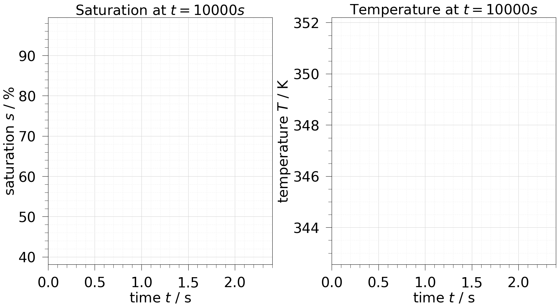

In the CTEST-small, the comparison is made for the time of 10000 seconds. The profiles of saturation and temperature are plotted below.
probe_points = np.column_stack((click to toggle)
    (np.arange(0, 0.012 * 201, 0.012), np.full(201, 0.1), np.zeros(201))
ms = ot.MeshSeries("ref_t_10000.000000.vtu")
ms_saturation = ot.MeshSeries.probe(
    ms, probe_points, saturation.replace(output_unit="")
ms_temperature = ot.MeshSeries.probe(ms, probe_points, temperature)
fig, ax = plt.subplots(figsize=(18, 10), ncols=2)
ot.plot.line(ms_saturation, saturation, ax=ax[0])
ot.plot.line(ms_temperature, temperature, ax=ax[1])
ax[0].set_title("Saturation at $t = 10000s$")
ax[1].set_title("Temperature at $t = 10000s$")
_ = [a.set_xlim(0, 2.4) for a in ax]

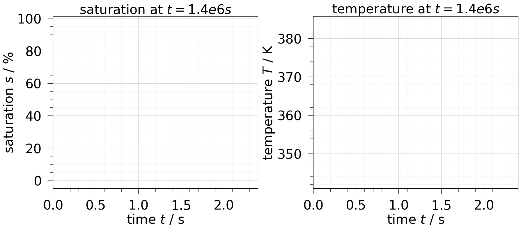

In the CTEST-large, the comparison is made for the time of 1.4e6 seconds. Around this time, the water is fully evaporated from the heating boundary (right hand side), and single phase zone of gas phase is formulated, while the temperature at this part begins to increase significantly, as shown below.
ms = ot.MeshSeries("ref_t_1400000.000000.vtu")(click to toggle)
fig, ax = plt.subplots(figsize=(18, 8), ncols=2)
ax[0].set_title("saturation at $t = 1.4e6s$")
ax[1].set_title("temperature at $t = 1.4e6s$")
