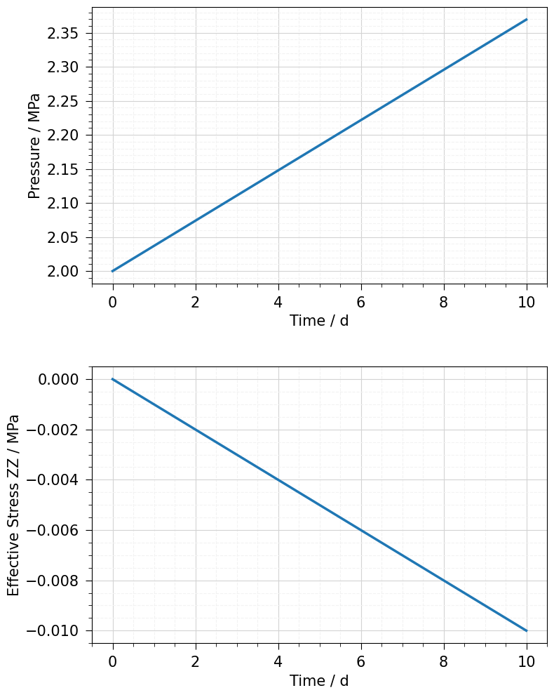

The obtained variations of pressure and effective stress at the end of the computation are shown in the two figures below:
fig, ax = plt.subplots(nrows=2, ncols=1, figsize=(8, 10))(click to toggle)
ot.plot.line(ms_pts, "time", ot.variables.pressure, ax=ax[0], fontsize=15)
ot.plot.line(ms_pts, "time", ot.variables.stress["zz"], ax=ax[1], fontsize=15)
ax[0].set_xlabel("Time / d")
ax[0].set_ylabel("Pressure / MPa")
ax[1].set_xlabel("Time / d")
ax[1].set_ylabel("Effective Stress ZZ / MPa")
plt.tight_layout()
plt.subplots_adjust(hspace=0.3)
