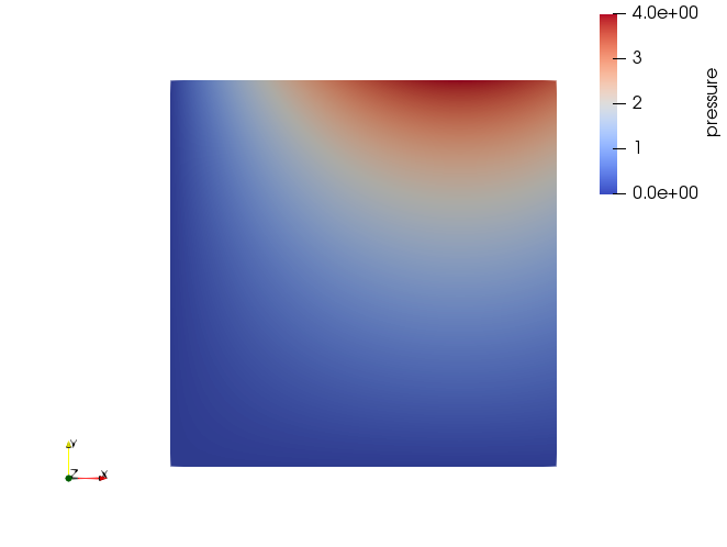

The numerical result obtained from OpenGeoSys is:

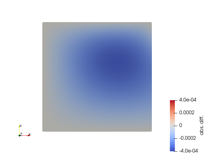

The absolute difference between the analytical and numerical solutions is smaller than $4 \cdot 10^{-4}$:
