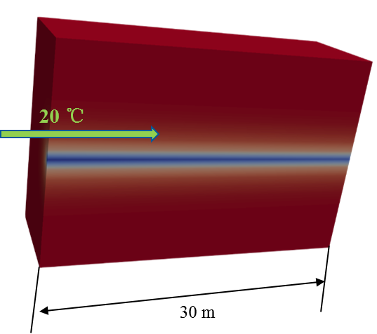

In this benchmark, the length of the wellbore is 30 m as shown in Figure 1 and the cold water is injected into the inlet point of the wellbore with the constant temperature of 20°C. The initial temperature of the fluid and grout in the wellbore is 20 $^{\circ}$C, and temperature of the surrounding rock is 55 $^{\circ}$C. The wellbore and pipe diameter are 0.28 m and 0.25826 m, respectively. And the flow rate is 0.0002 $m^3/s$.
Single pipe flow model
Figure 1: Single pipe flow model

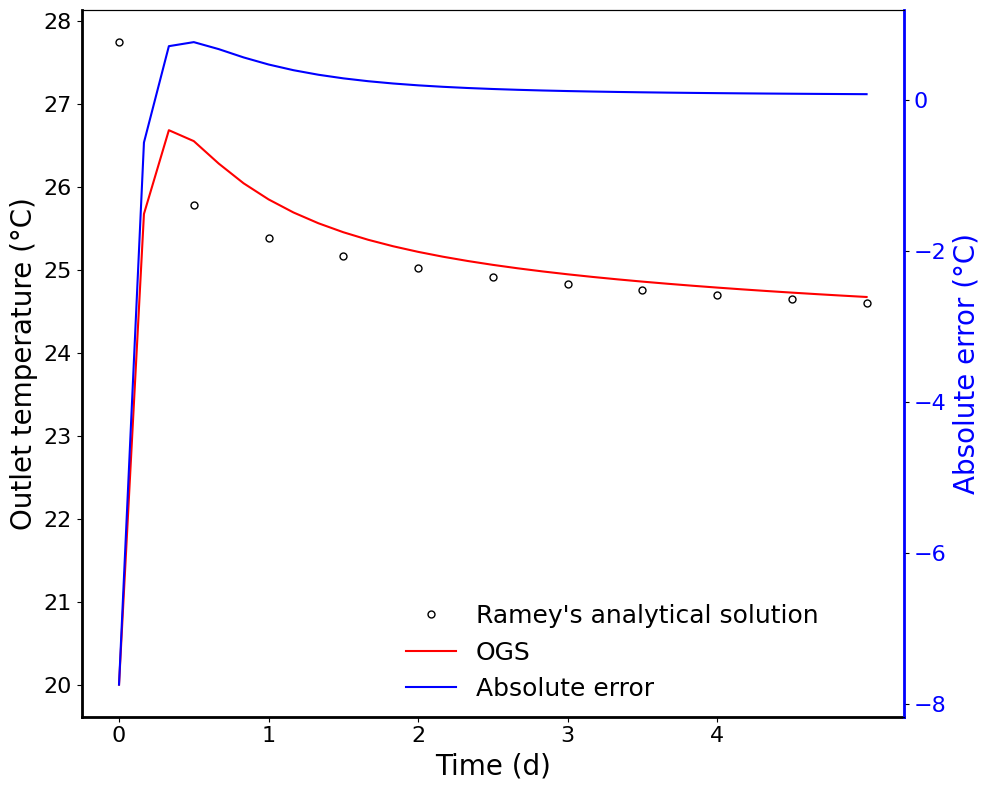

The outlet temperature change over time was compared against the analytical solution and presented in Figure 2. After 30 days, the fluid temperature distribution in the wellbore is shown in Figure 3. The maximum relative error between the numerical model and Ramey’s analytical solution is less than 0.15%.
In numerical model, the outlet temperature at beginning stage is affected by the initial temperature in the pipe inside the wellbore. The initial fluid temperature set in the benchmark means there is water with 20°C filled in the wellbore already before injecting water into the wellbore. But in the analytical solution, no initial temperature is set and the temperature keeps equilibrium state at every moment. The impact of initial temperature condition in numerical model is decreasing with the increasing of the operational time as shown in Figure 2.

# Plot numerical vs. analytical result(click to toggle)
fig, ax1 = plt.subplots(figsize=(10, 8))
x_pos = np.arange(0, 432000, 60 * 60 * 24)
x_ticks = np.arange(0, 5, 1)
ax1.plot(
    time_range,
    data.iloc[-1, :],
    "k.",
    markersize=10,
    markerfacecolor="none",
    label="Ramey's analytical solution",
ax1.plot(time, temperature_BHE1_tube, "r", label="OGS")
ax1.set_ylabel("Outlet temperature (°C)", fontsize=20)
ax1.set_xlabel("Time (d)", fontsize=20)
ax1.set_xticks(x_pos, x_ticks)
ax1.spines["left"].set_linewidth(2)
ax1.spines["bottom"].set_linewidth(2)
ax1.tick_params(axis="both", labelsize=16)
color = "blue"
ax2 = ax1.twinx()
ax2.plot(time, temperature_BHE1_tube - T_0, color=color, label="Absolute error")
ax2.set_ylabel("Absolute error (°C)", color=color, fontsize=20)
ax2.tick_params(axis="y", labelcolor=color)
ax2.spines["right"].set_color("blue")
ax2.spines["right"].set_linewidth(2)
ax2.tick_params(axis="y", labelsize=16)
plt.figlegend(fontsize=18, loc=(0.4, 0.1), frameon=False)
Figure 2: Comparison with analytical solution results

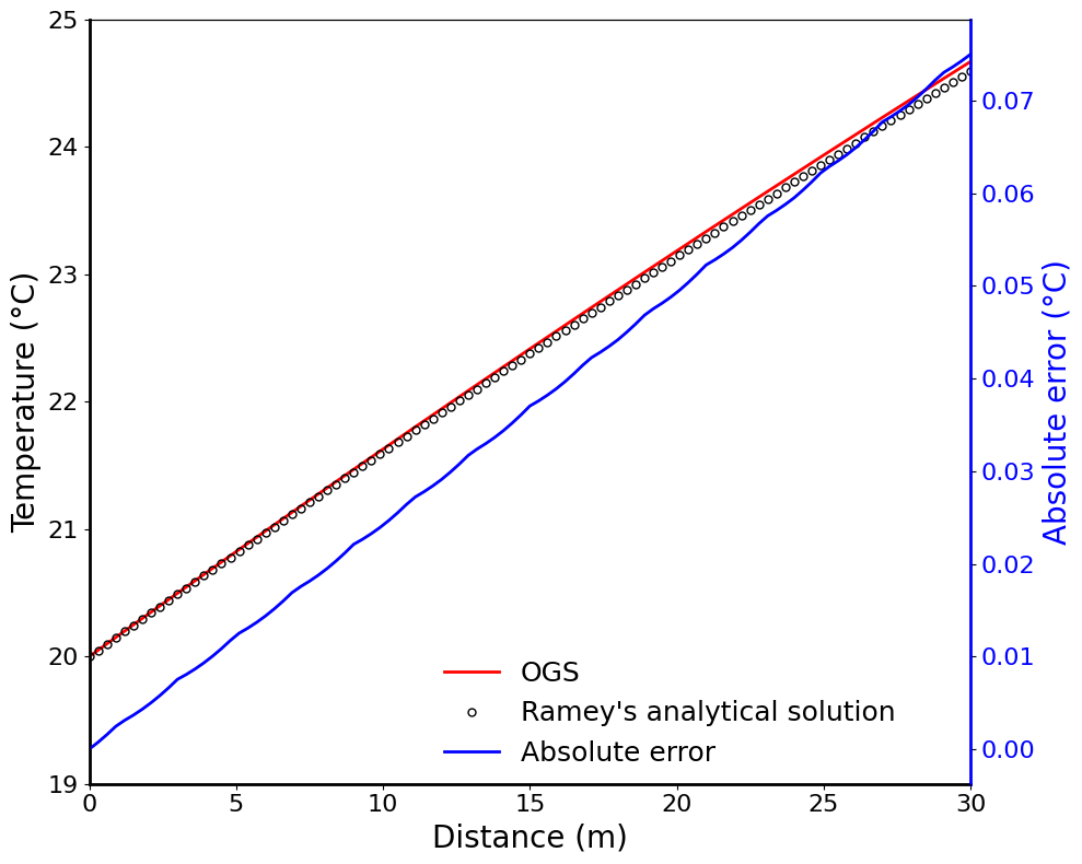

# Extract values along a line in the domain(click to toggle)
# Space axis for plotting
length = np.linspace(0, -30, 101)
x_axis = [(0, 10, i) for i in length]
# At timestep i
i = -1
temp = ms.probe_values(x_axis, bhe_temp, interp_method="linear")[i]
# Plot
ax1.set_xlabel("Distance (m)", fontsize=20)
ax1.set_ylabel("Temperature (°C)", fontsize=20)
ax1.plot(np.linspace(0, 30, 101), temp, "r", linewidth=2, label="OGS")
ax1.plot(
    Z,
    data.iloc[:, -1],
    "k.",
    markersize=10,
ax1.set_ylim(19, 25)
ax1.set_xlim(0, 30)
color = "blue"
ax2 = ax1.twinx()
ax2.plot(
    temp - data.iloc[:, -1],
    linewidth=2,
    color=color,
    label="Absolute error",
max_error = 0.08
if np.max(np.abs(temp - data.iloc[:, -1])) > max_error:
    msg = f"The maximum temperature error is over {max_error} °C, which is higher than expected"
    raise RuntimeError(msg)
Figure 3: Distributed temperature of fluid and absolute error.
