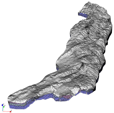

  1. Extract surface using ExtractSurface (a: Original subsurface mesh; b: Extracted surface)
    Sub-surface mesh
    Sub-surface mesh

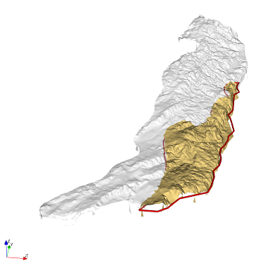

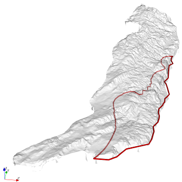

  2. Mark the mesh elements within the polygonal region deploying the tool ResetPropertiesInPolygonalRegions
    Surface and polygon
    Surface and polygon
    Marked elements in polygonal region are colored yellow

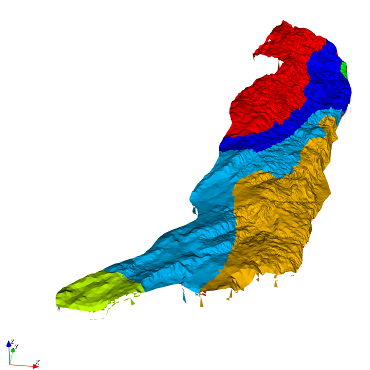

    Marked regions visualized by different colors

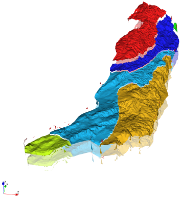

  3. Remove marked/unmarked mesh elements deploying tool removeMeshElements
    Resulting patches visualized by different colors and z-translations
