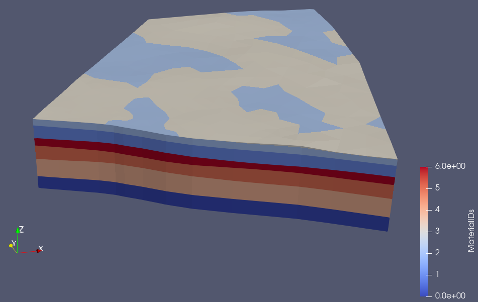

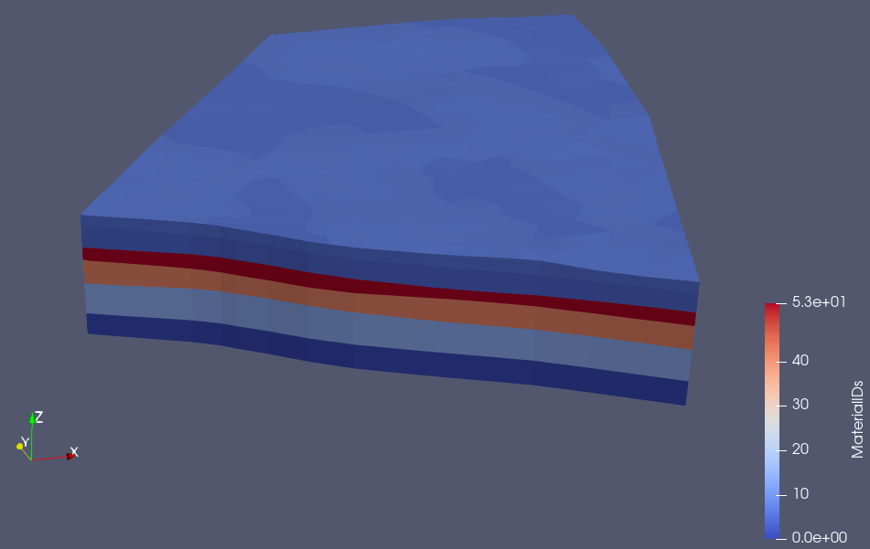

Fig.1 The upper image shows a mesh with material IDs [0,4,5,6,14,42,53]. The lower one the same mesh with material IDs [0,1,2,3,4,5,6] after applying --condense.
