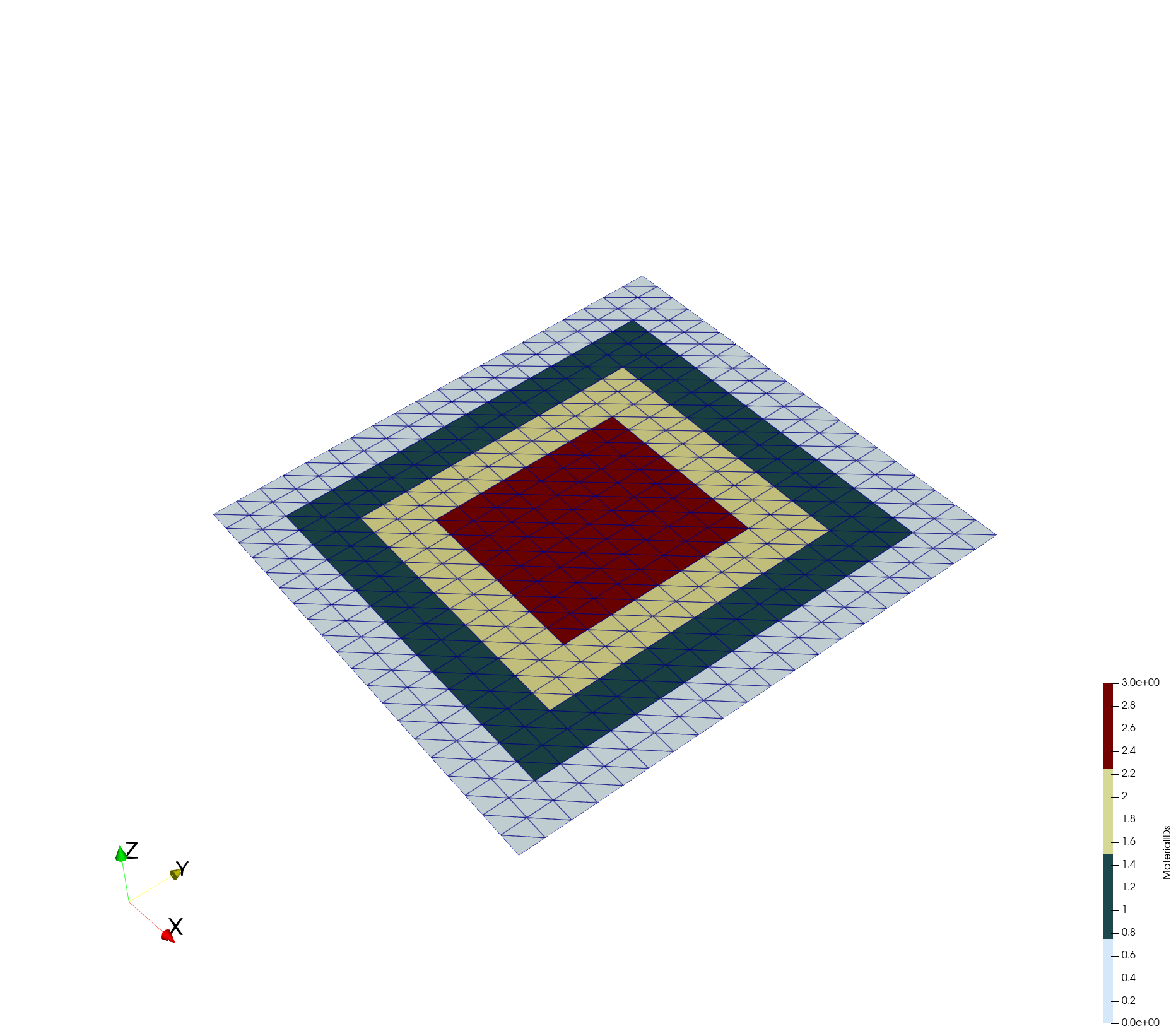

2d input mesh
Fig.1 2D input mesh mapped to an elevation (generated with the tool MeshMapping, although it is not necessary to use a mapped mesh, a flat mesh is sufficient). The z-values of the mesh are scaled by a factor of 10.

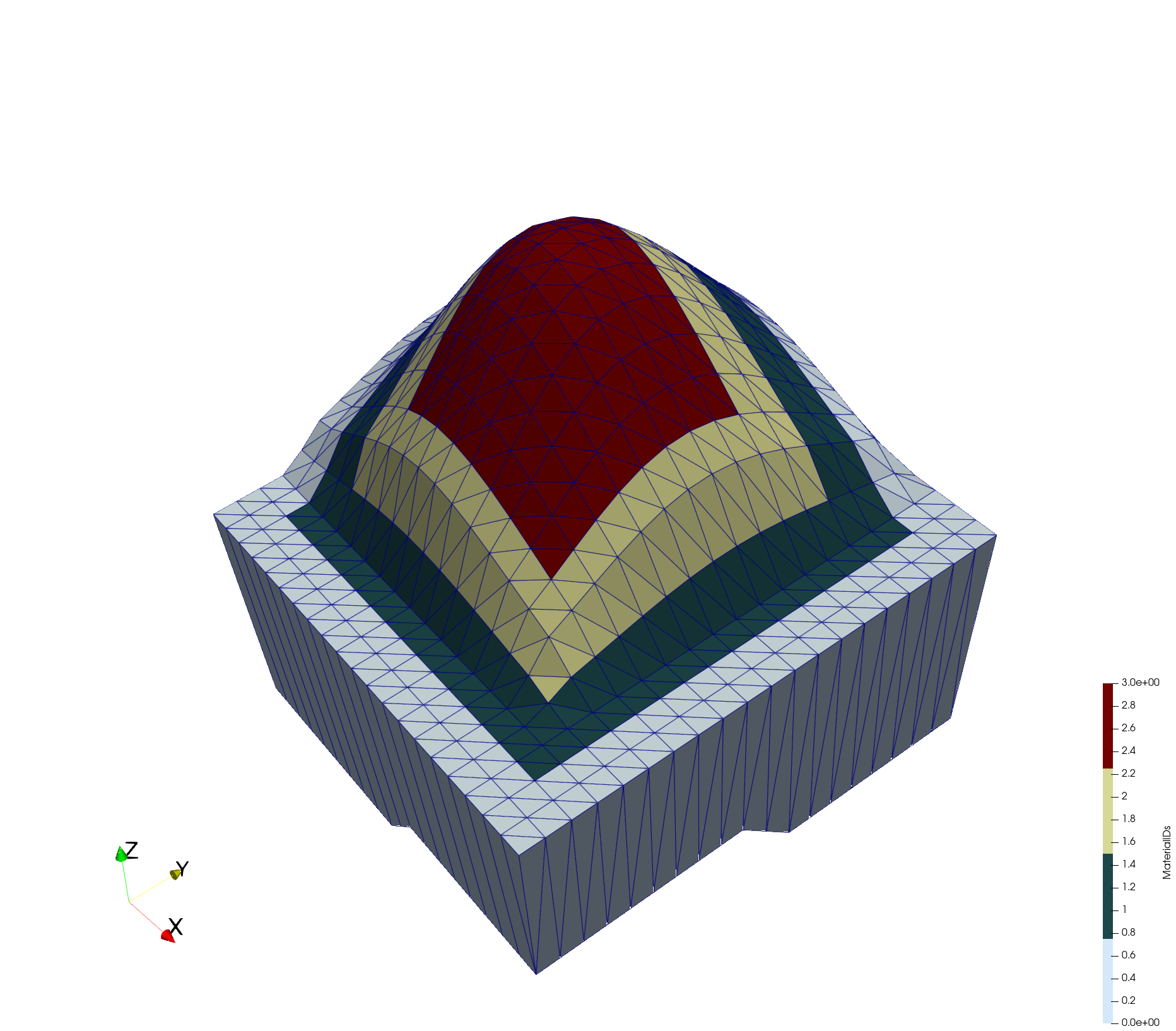

layered output mesh
Fig.2 The layered 3D output mesh created from raster files. The different colors depict different material IDs. The z-values of the mesh are scaled by a factor of 10.

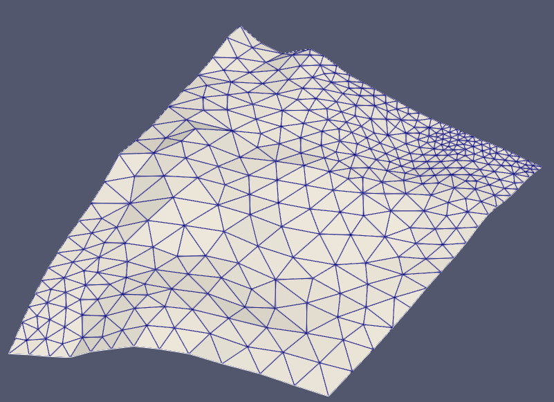

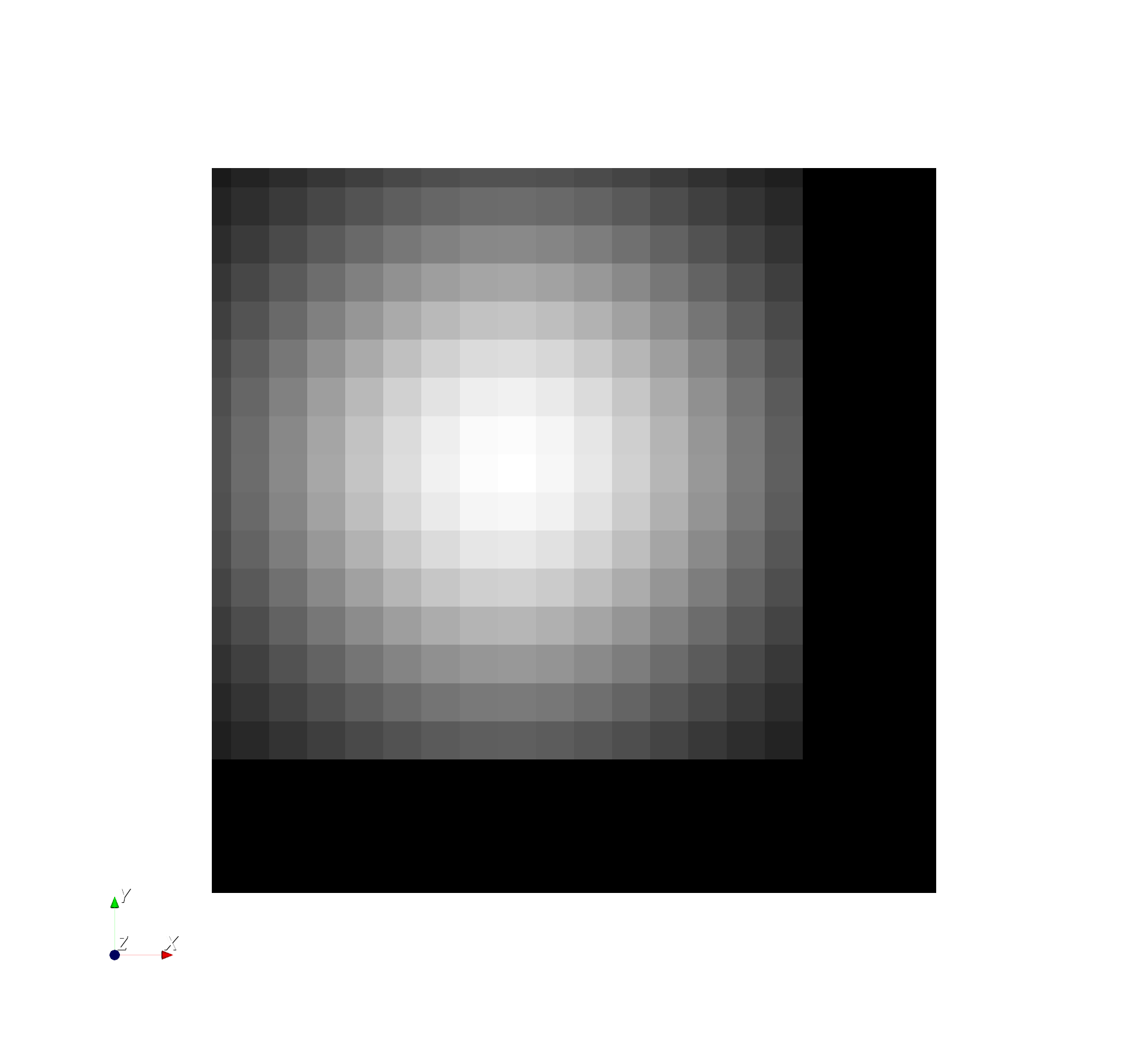

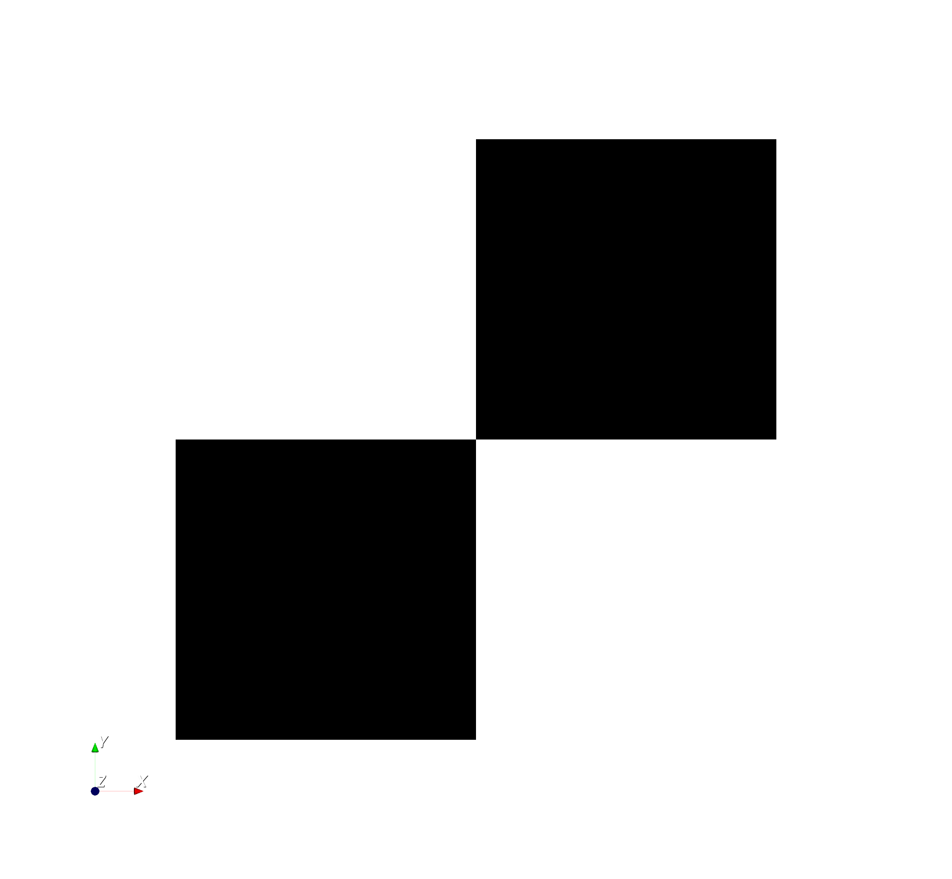

2d input mesh and the input rasters:
2d top mesh bottom raster top raster

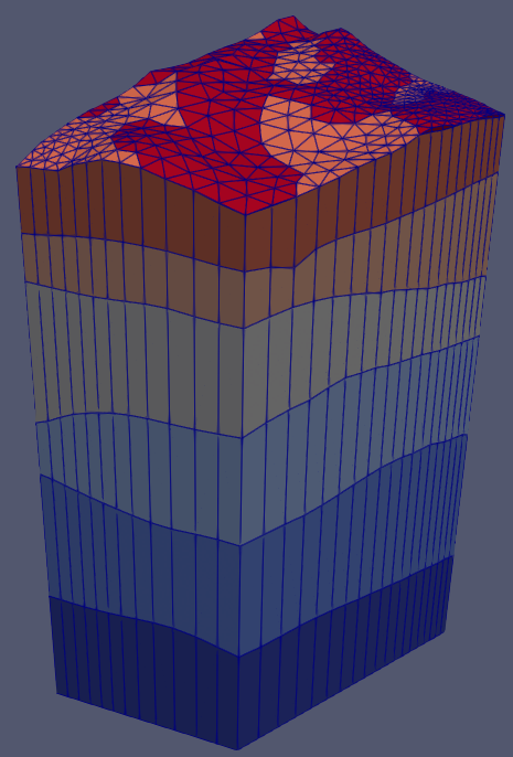

The result is then a 3d mesh with a material ID distribution as it is in the 2d mesh provided as input.
3d subsurface mesh
