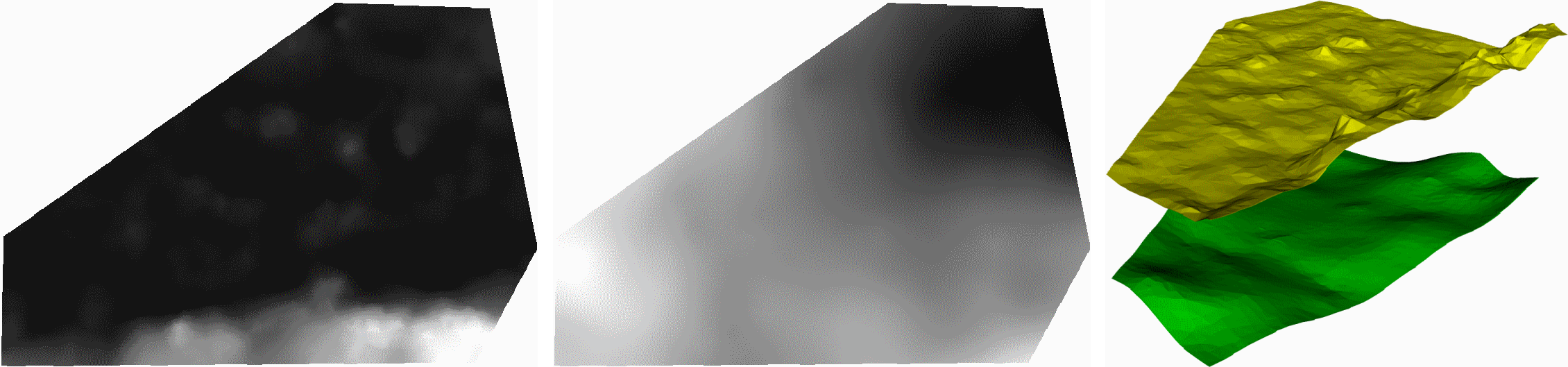

Input data:
Two input rasters
Two input rasters as well as their 3D surface representation. Darker pixels represent values at a lower elevation while brighter pixels represent higher elevaton. In the 3D visualisation, the left-most raster is represented by the yellow surface and the right-most raster by the green surface.

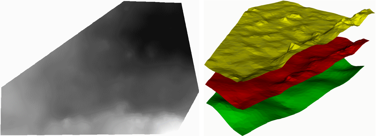

createIntermediateRasters --file1 raster1.asc --file2 raster2.asc -o output.asc -n 1
A new raster is created in the exact center between the two input rasters
A new raster is created in the exact center between the two input rasters. In the 3D representation, the new layer is shown in red.

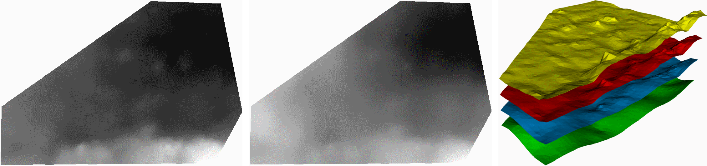

createIntermediateRasters --file1 raster1.asc --file2 raster2.asc -o output.asc -n 2
For n=2, two new raster are generated, represented here in red and blue.
For n>1 multiple rasters are created at equidistant distances between the two input rasters. For n=2, two new rasters are generated, represented here in red and blue.
