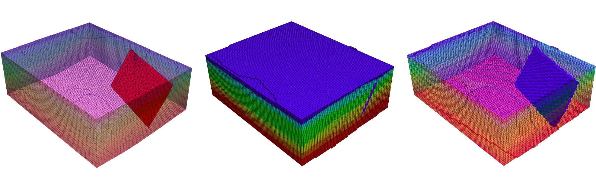

Fig. 1 The left figure shows the input grid with the intersecting triangulated 2D mesh, which is highlighted in red. The center and right figure show the output voxel grid.
