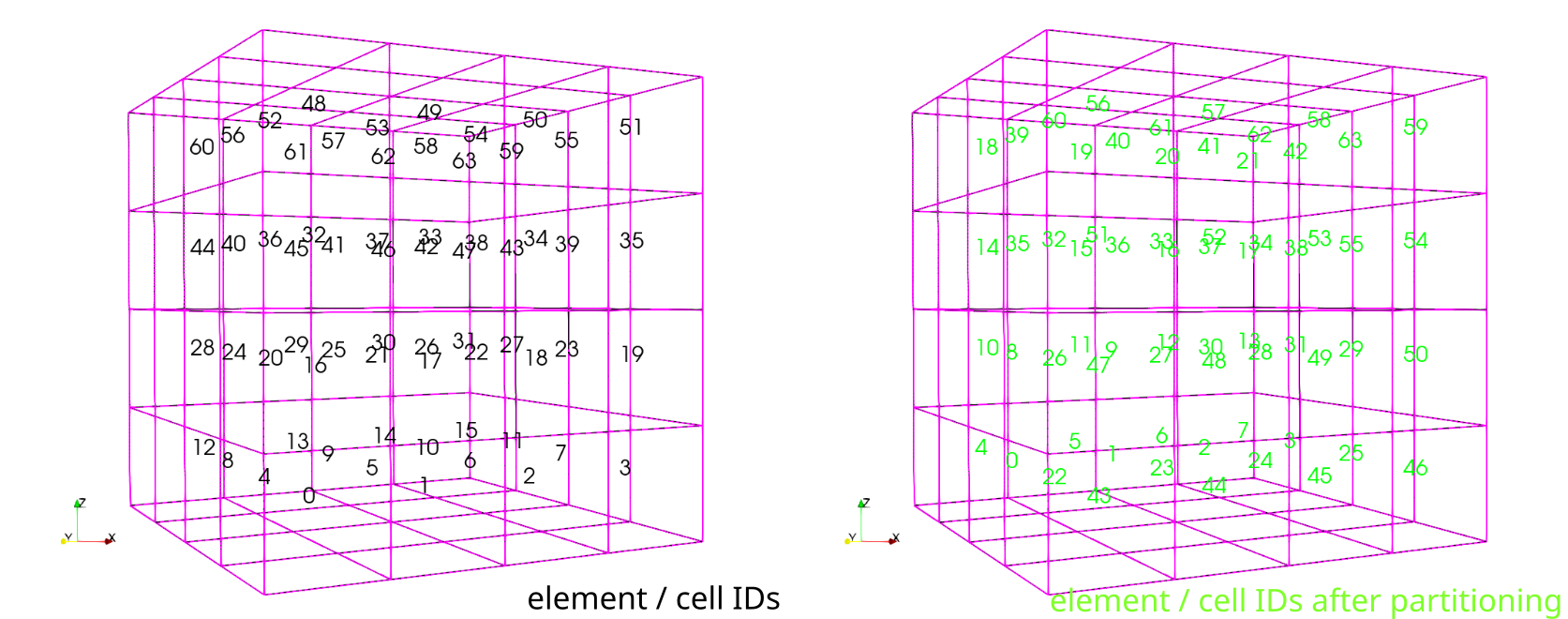

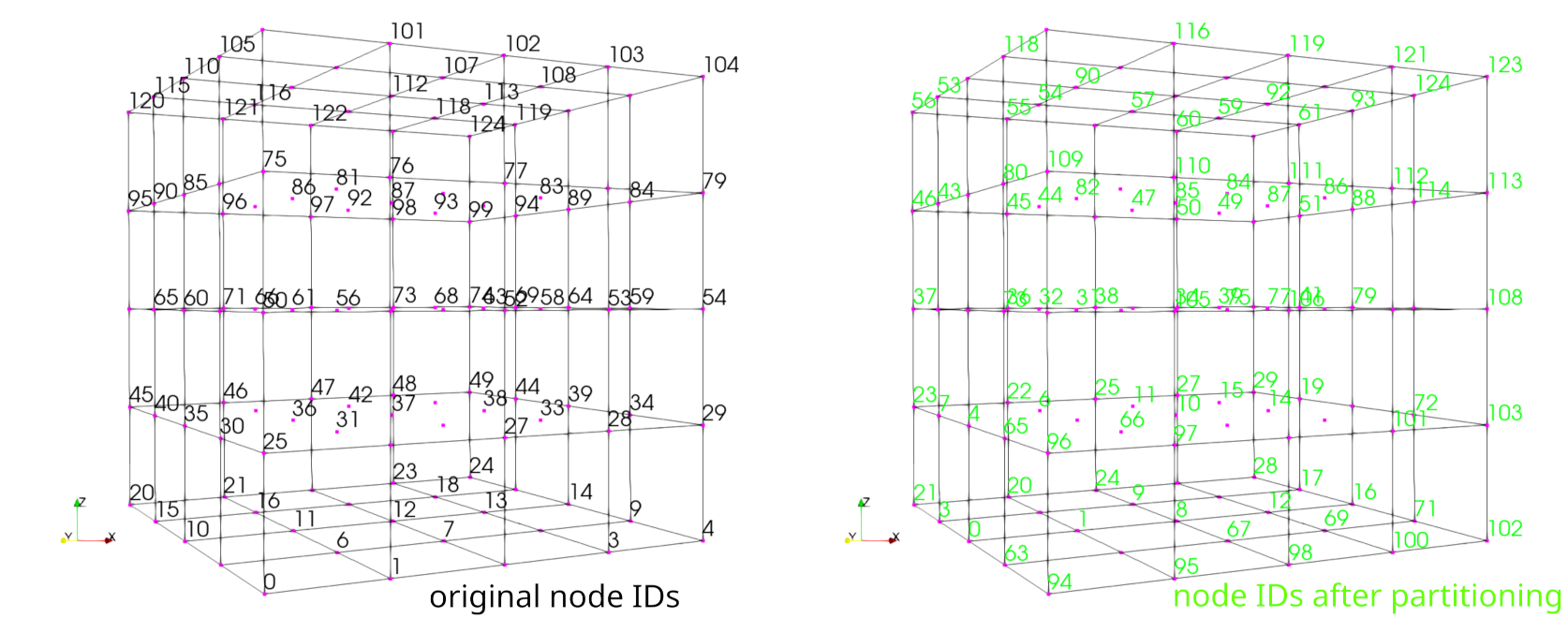

a domain decomposition is required as a preprocessing step. As you can see in the following pictures the domain decomposition (into 2 sub-domains) changes the sequence of nodes and elements. On the left the initial node and element orderings are depicted, on the right the ordering after partitioning is shown.
Node IDs in the bulk mesh for the serial simulation
Element IDs in the bulk mesh for the serial simulation
Simple element-wise or node-wise comparisons of simulation results are not possible. The tool ReorderMesh can be applied to reorder the nodes and elements to the initial ordering.
