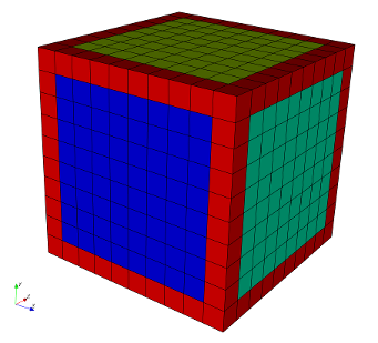

Input
The left figure above is the result of the repeated application of SetPropertiesInPolygonalRegion. It contains material ids 0 (red), 1 (yellow), 2 (turquoise) and 3 (blue).

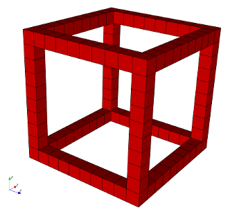

The result of the following command line input is depicted.
removeMeshElements -i TestCube-ResetPropertiesInPolygonalRegion.vtu -o TestCube-removeMeshElements.vtu -n MaterialIDs --int-property-value 1 --int-property-value 2 --int-property-value 3
