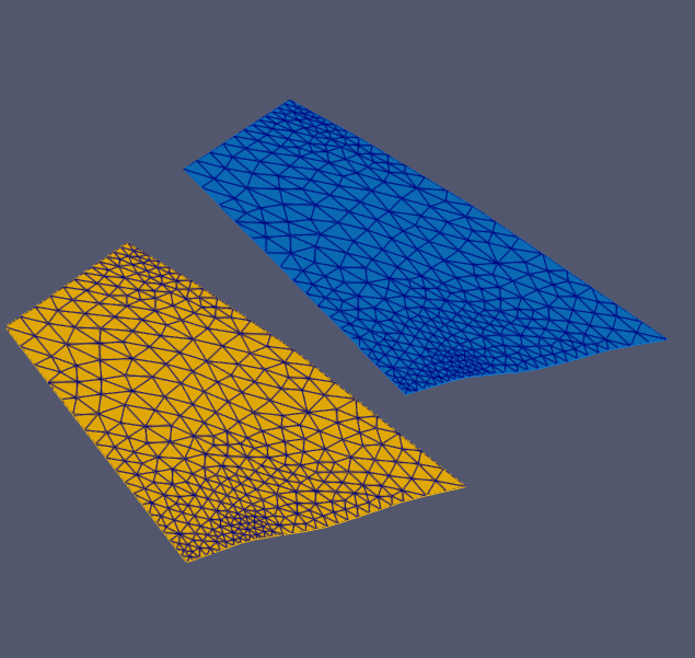

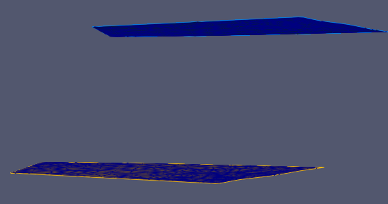

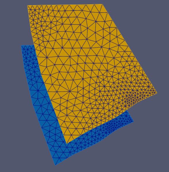

Fig.1 Three images showing the same meshes from different point of views (POV). The yellow mesh depicts the input mesh and the blue one the output mesh. The upper image is from an isometric POV, the center image is the view along the x-axis POV and the lower one along the z-axis.
