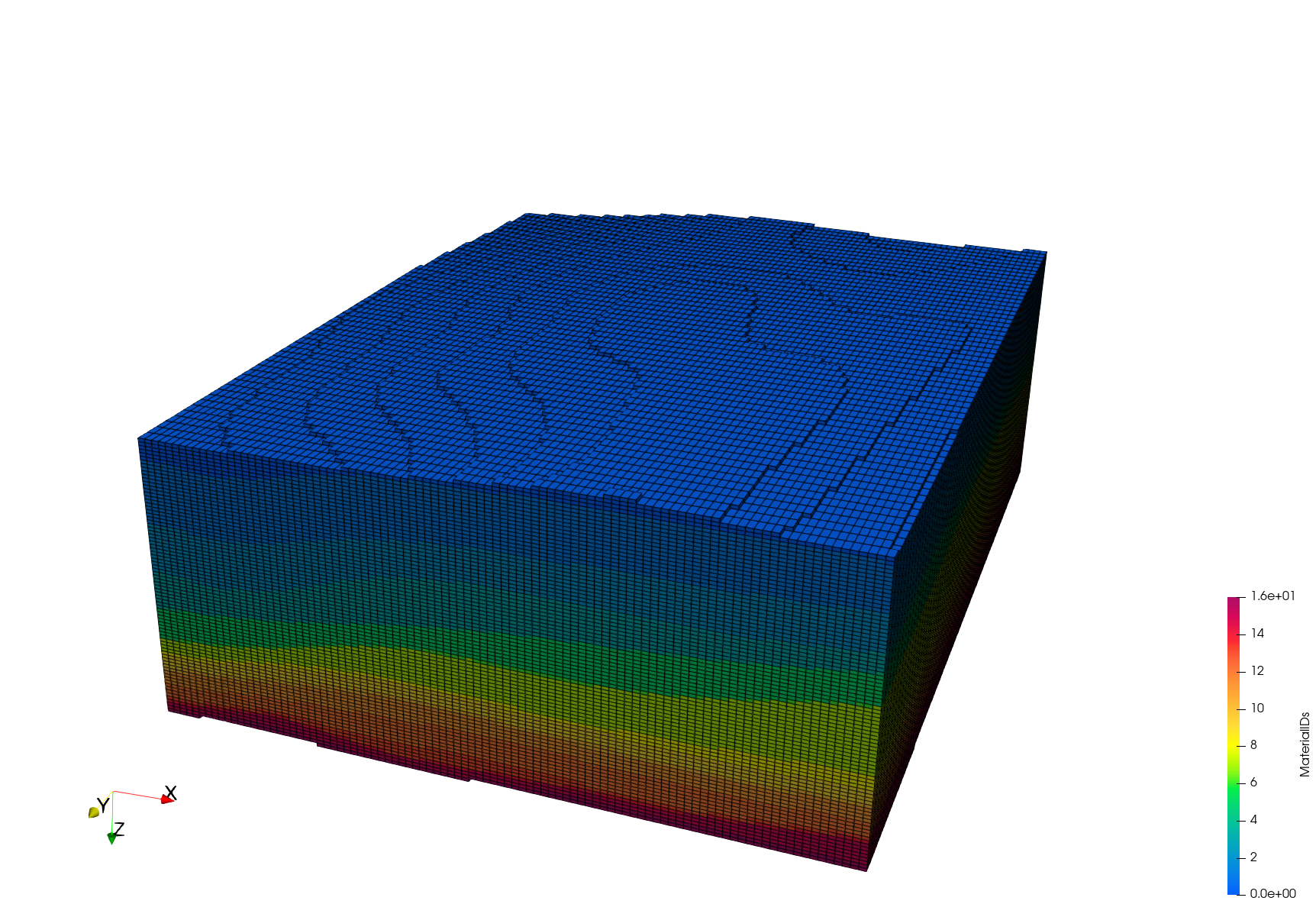

In this example we will present how to create a voxel grid (output) from a list of layers in VTK-format (input).
Layers2Grid -i layers.txt -o layers2grid.vtu -x 100 -y 200 -z 50
The list must contain the paths of the input layers as well as their names. The voxel grid is build in the same order as the names are listed from top to bottom.

Fig.1 The voxel grid composed of elements of size x=100, y=200 and z=50.
