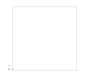

geometry
1x1 square geometry

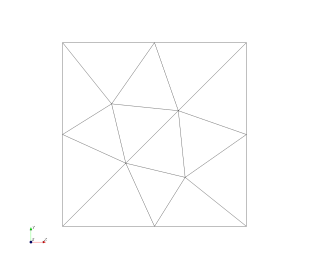

coarse mesh
simple coarse mesh (density scaling 0.5)

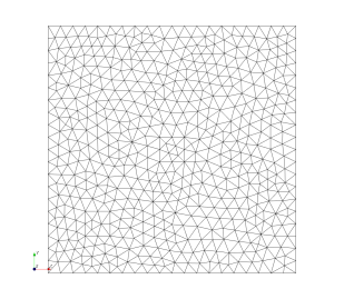

fine mesh
simple fine mesh (density scaling 0.05)

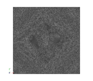

even finer mesh
even finer mesh (density scaling 0.005)

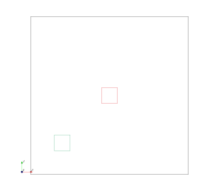

geometry
1x1 square geometry and sub geometries

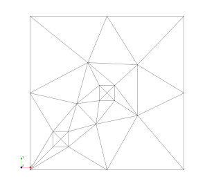

coarse mesh

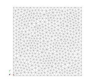

fine mesh
