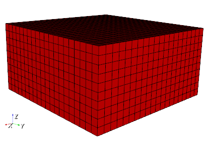

One material
A simple cube mesh with one material group (red).

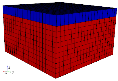

Added layer
The updated mesh where an additional layer (blue) was added on top of the domain with a second material group.
Usage for example:
AddLayer -i quad.vtu -o quad_with_new_top_layer.vtu -t 1
