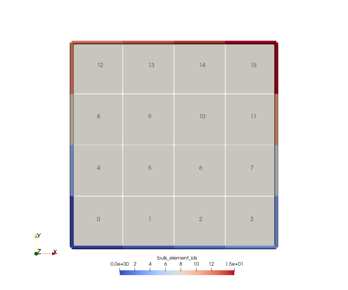

Extract the boundary from a quad mesh
ExtractBoundary -i square_1x1_quad.vtu -o square_1x1_quad_border.vtu
The square mesh consists of 16 cells/elements.
The square mesh consists of 16 cells/elements. The numbers in the cells are the cell IDs. The generated boundary grid consists of the somewhat thicker and colored line elements.

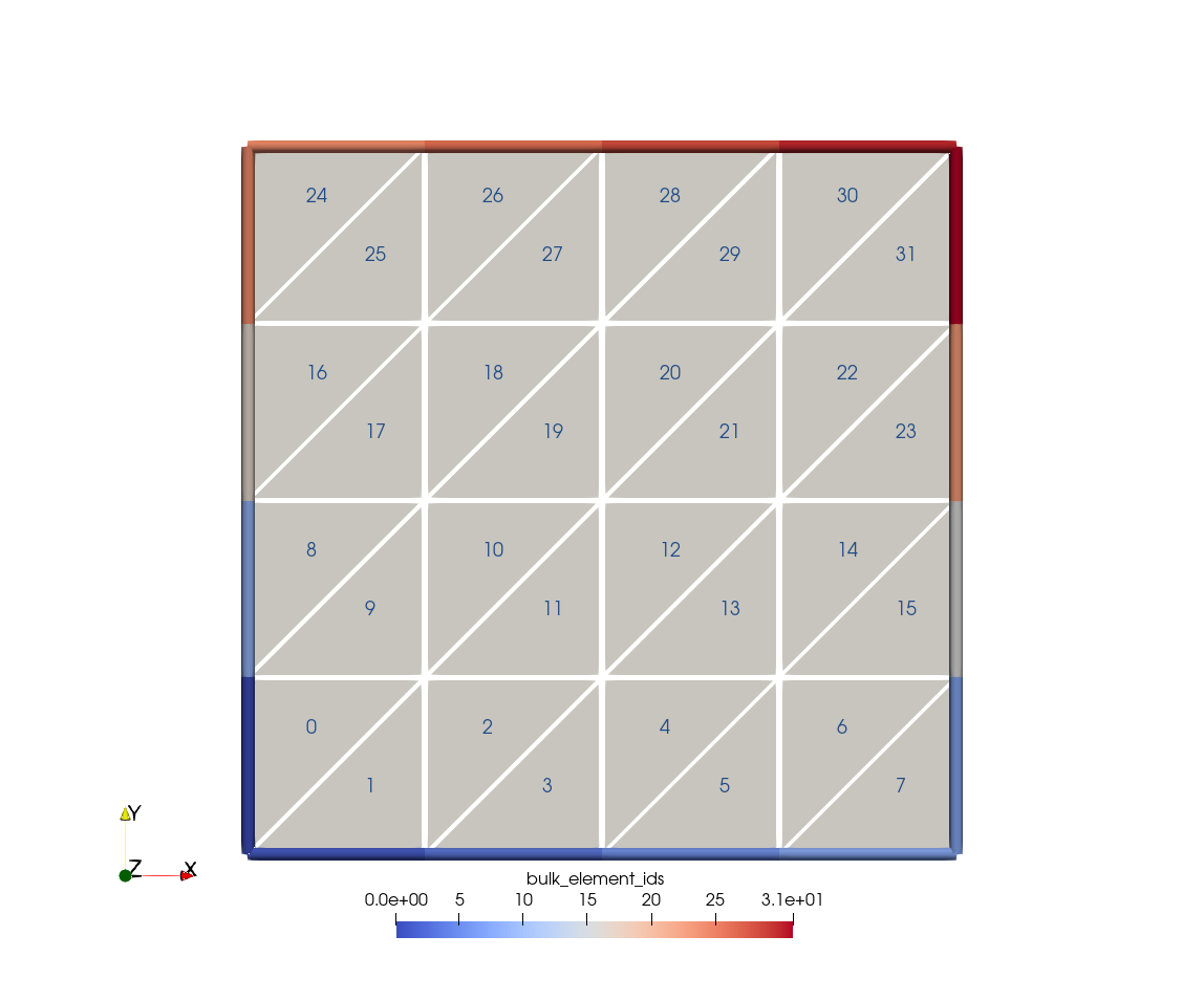

Extract the boundary from a triangular mesh
ExtractBoundary -i square_1x1_tri.vtu -o square_1x1_tri_border.vtu
The square mesh consists of 32 triangle shaped cells.
The square mesh consists of 32 triangle shaped cells. The numbers in the triangle are the cell IDs. The generated boundary grid consists of the somewhat thicker and colored line elements.
