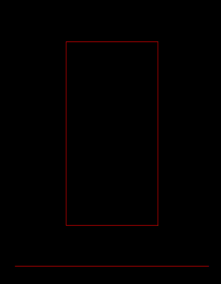

Subdivisions can be made along all 4 edges of a quad. The input is a number that defines the amount of equidistant points that are created on the corresponding edge/line. When a mesh is generated using this geometry, these points are also integrated into the mesh. Generating subdivisions along a line is done by --nx, --ny or --nz depending on the axis the line is parallel to.
In this example we generate a line by defining two points p0 = (-4,-2,3) and p1= (15,-2,3). Here, a line is generated because y0 = y1 = -2 and z0 = z1 = 3 for the two points. This means the defined points are in a line parallel to the x-axis.
generateGeometry -o line.gml --x0 -4 --x1 15 --y0 -2 --y1 -2 --z0 3 --z1 3
In this example we generate a quad by defining two points p0 = (1,2,3) and p1= (10,20,3). Here, a plane is generated because z0 = z1 = 3 for the two points. This means the defined points are in a plane parallel to x-y-plane.
generateGeometry -o quad.gml --x0 1 --x1 10 --y0 2 --y1 20 --z0 3 --z1 3
Fig.1 Visualization of the generated quad and the line viewed along the z-axis.
