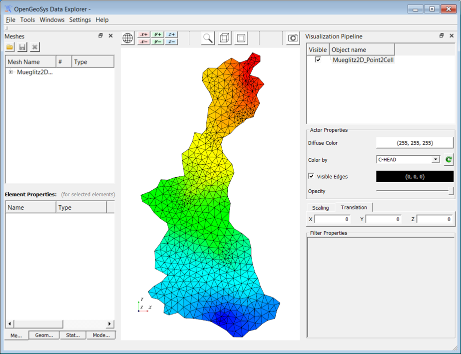

Input data:
Input
2D surface mesh with scalar data assigned to cells, here displayed via the OGS Data Explorer. In this particular case, the simulation result of groundwater flow simulation (originally assigned to mesh nodes) has been converted onto cells via VTK’s PointToCell-Filter.

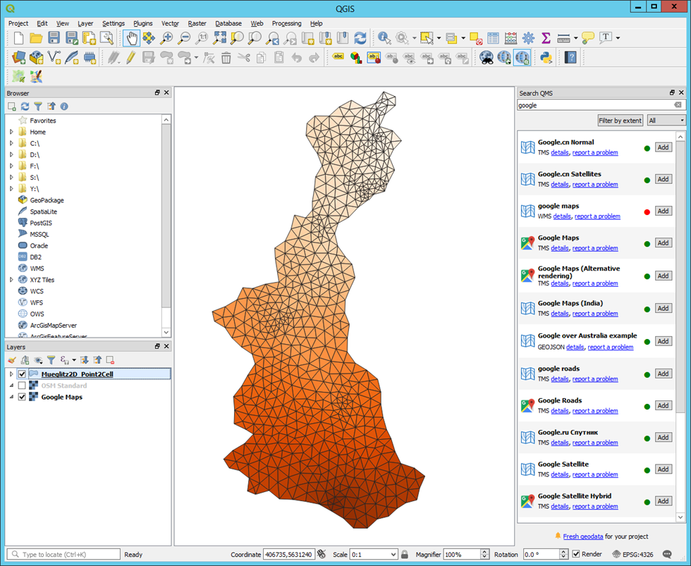

Exported shapefile
Exported shapefile displayed in a geographic information system (here, QGIS).

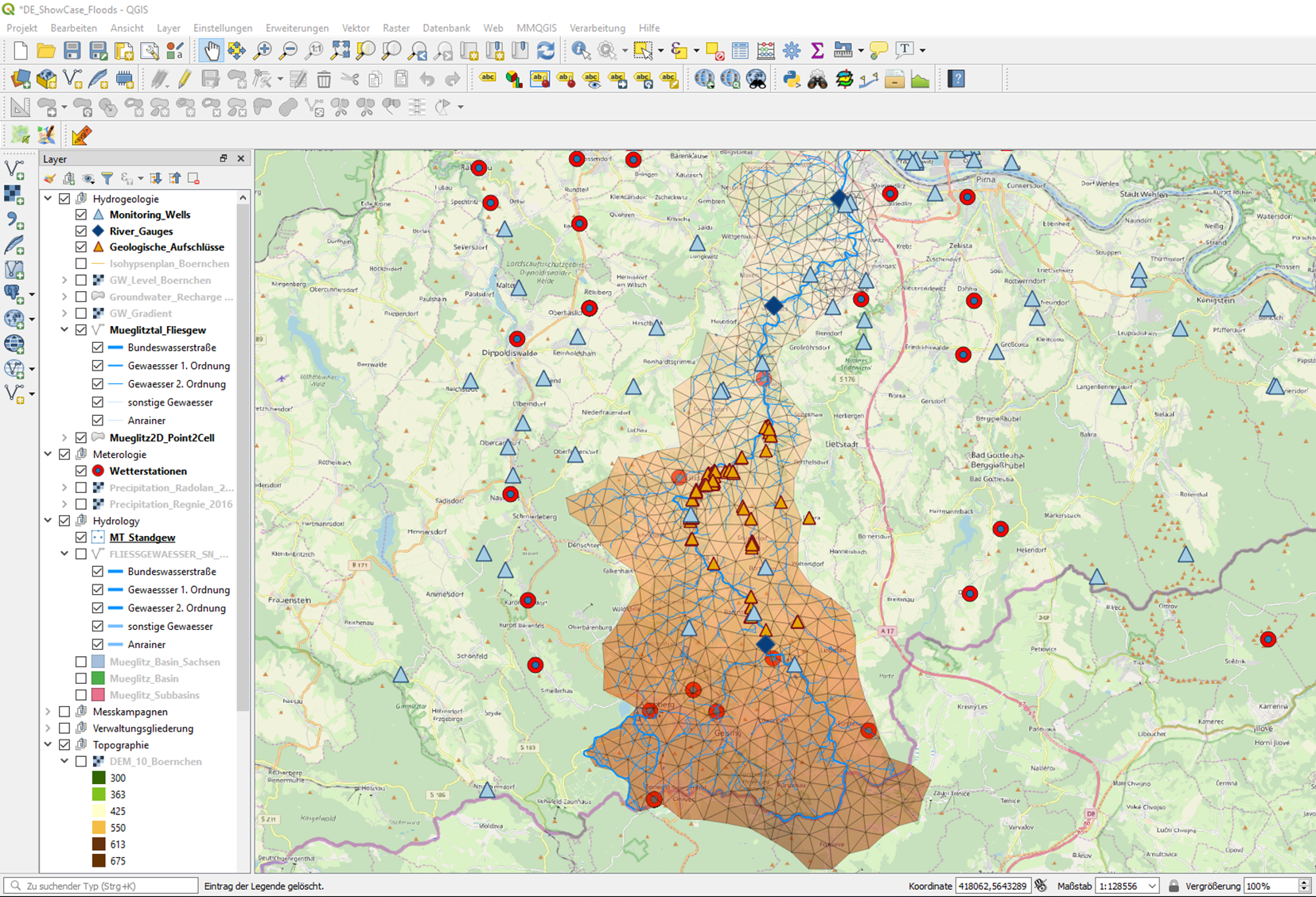

OGS simulation result
The result of an OGS-simulation showing the groundwater head of the Müglitz-catchment imported into QGIS and combined with other data from an existing GIS-project of this region.
