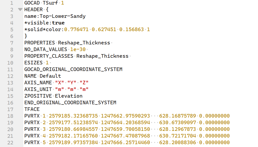

Input:
GoCAD-Header
GoCAD-Header of file containing triangulated surface.

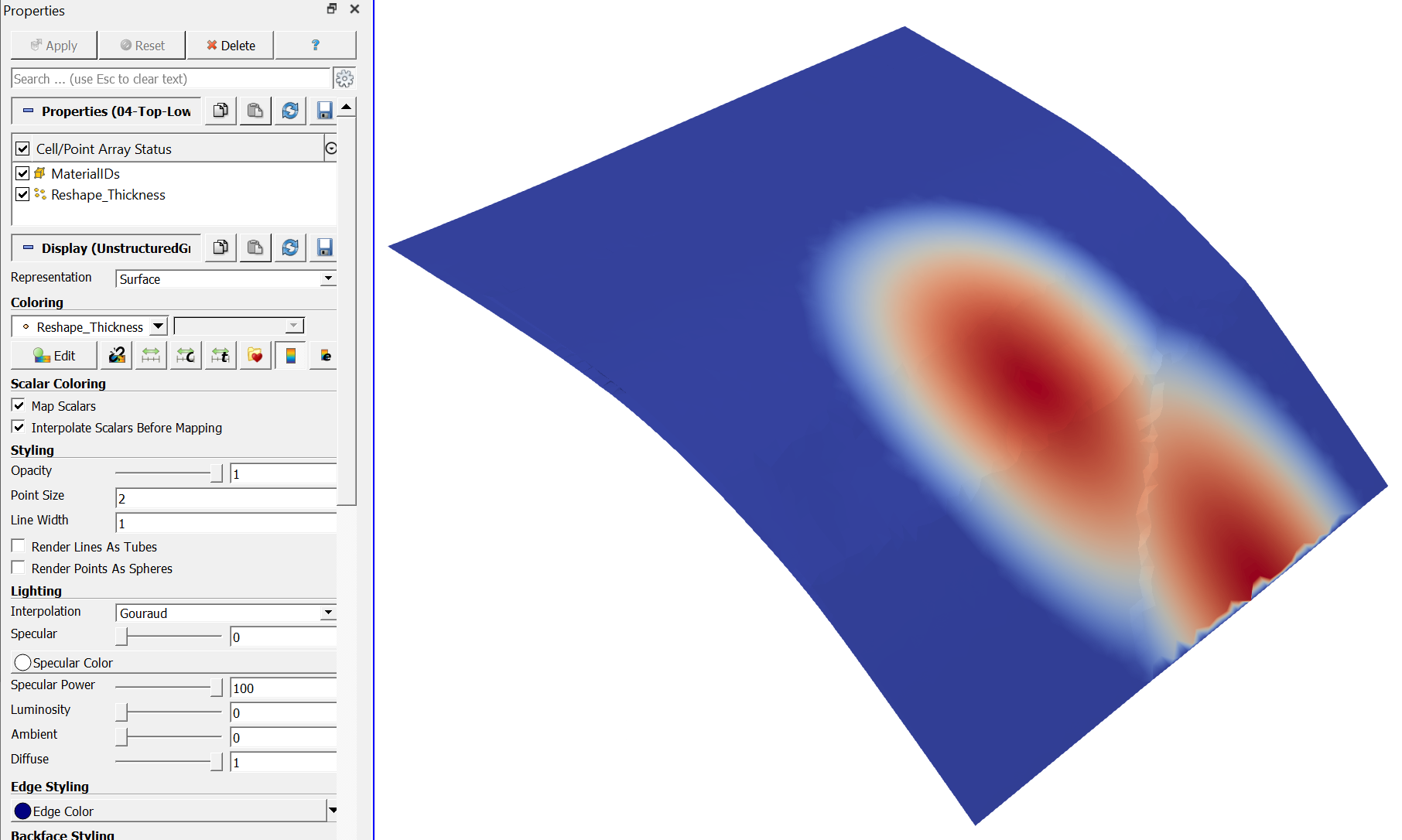

Output:
Converted surface
Converted surface visualised in ParaView with scalar data added to nodes.
