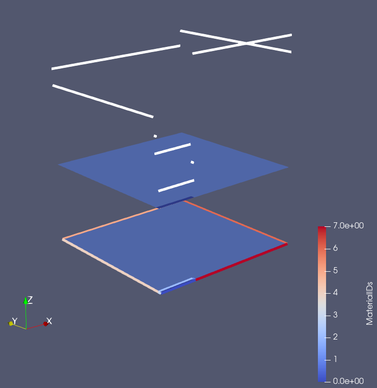

GMSH2OGS creates different meshes from the same input depending on the -e and -b flags; the results are shown (z-translated) in the figure below.
GMSH2OGS -i A2-gmsh.msh -o A2.vtu
  • Conversion without any additional flags yields a single VTU file with outer and inner boundaries (line elements) included, shown in the very bottom.
  • Adding only a -e flag results in a single VTU file, now without the line elements.
  • Adding only a -b flag gives a single VTU file as in the first case and additional eight files, each containing a line-element mesh corresponding to the physical groups; these are the white lines in the figure, shown again z-translated.
  • Finally specifying both flags (-e and -b) produces a single VTU file without the line elements and additional eight boundary (subdomain) files.

GMSH2OGS meshes for -e and -b command line flags.
