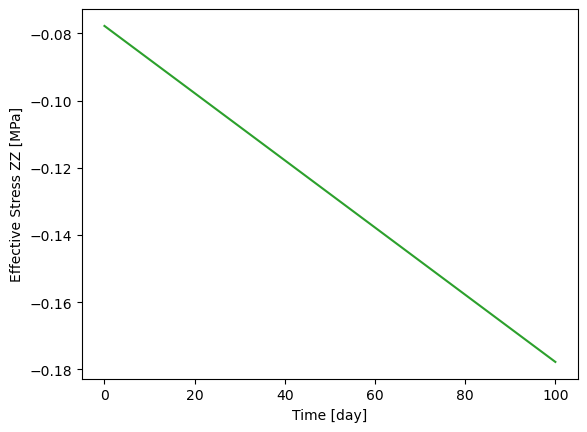

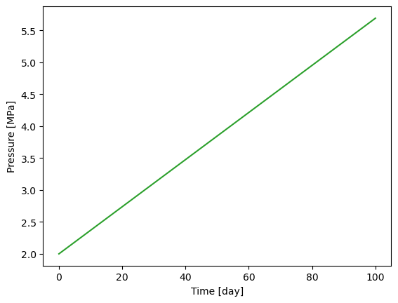

As a CTest, only 5 time steps with a fixed time step size $1.728\cdot 10^4$ s are computed. If the example is run up to 50 time steps, corresponding to 100 days of simulation time, the variations of pressure and effective stress can be obtained as that are shown in the two figures below:
