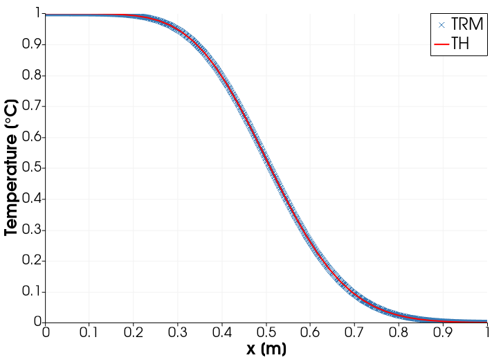

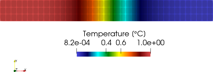

This example is also set as one of the benchmarks of ThermoHydroMechanics (THM) and ThermoRichardsMechanics (TRM), respectively. In order to provide a reference result for the same benchmark of THM and TRM, a 2D domain of 1 m $\times$ 0.1 m is used, which is discretised into 3$\times$39 quadrilateral elements.

The temperature distribution at t= 5.e+4 s together with the mesh is illustrated in the following figure:
The temperature profile at t= 5.e+4 s along a horizontal line in the 2D domain is given in the following figure:
