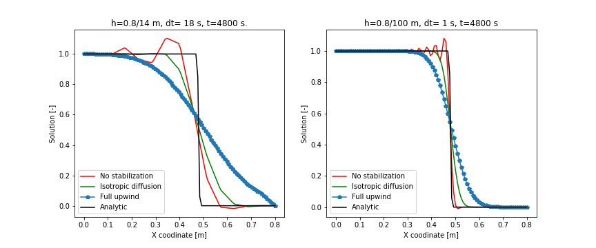

The example is described in Classical transport example: using the isotropic diffusion stabilization.
The following two figures compare the example results with the analytical solution and that are obtained by using the isotropic diffusion stabilization.
From the figures we can see that the full upwind scheme adds more diffusion than the isotropic diffusion scheme does.
