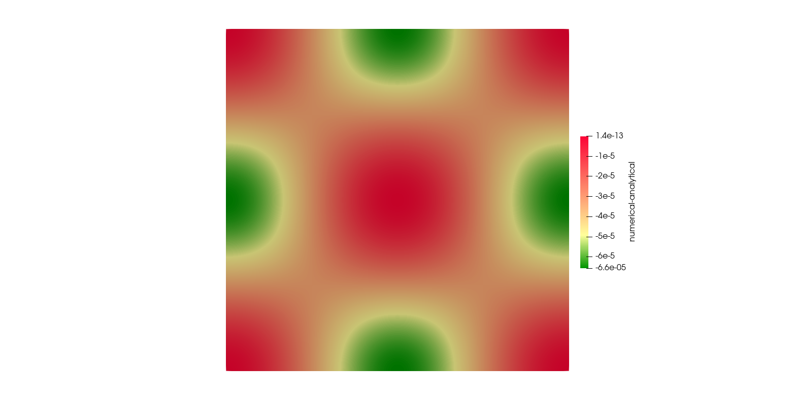

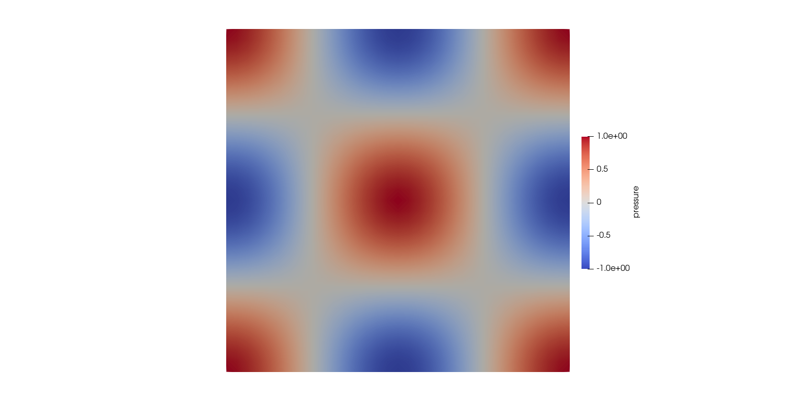

Comparison of the numerical and analytical solutions
The above picture shows the numerical result. The solution conforms in the edges to the prescribed boundary conditions.
Since a coarse mesh ($32 \times 32$ elements) is used for the simulation the difference between the numerical and the analytical solution is relatively large.

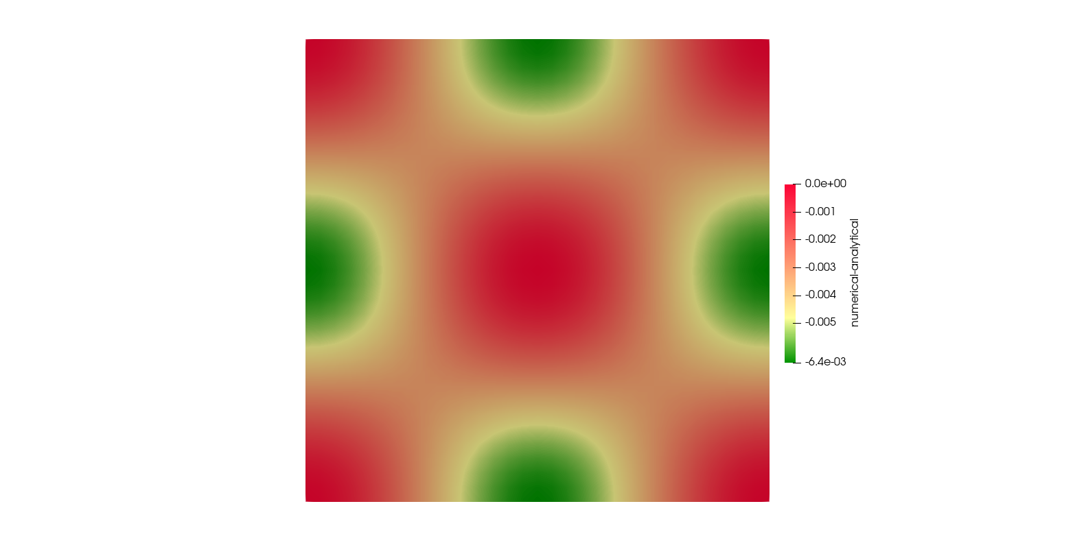

Comparison for higher resolution mesh ($316 \times 316$ elements)
The difference between the numerical and the analytical solution is much smaller than in the coarse mesh case.
