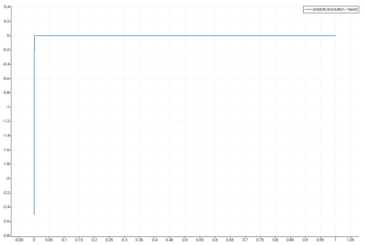

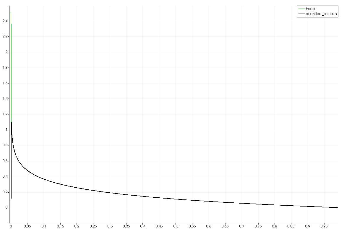

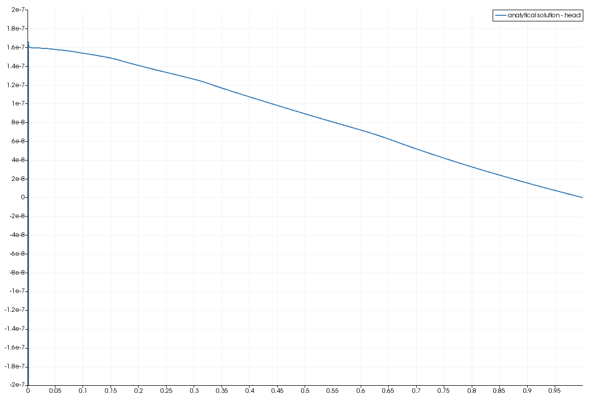

Comparison of the analytical solution and the computed solution
