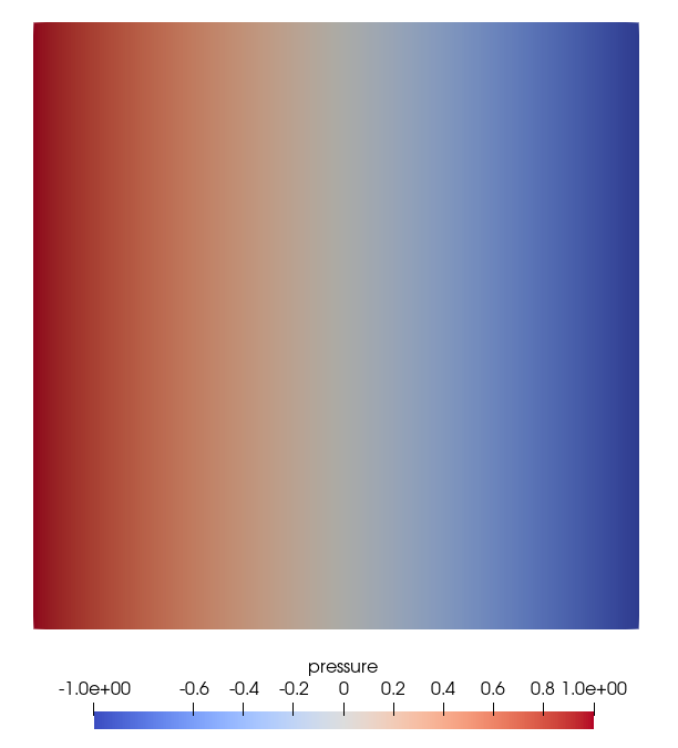

We solve the Laplace equation on a square domain $[0\times 1]^2$ with $k = 1$ w.r.t. the specific boundary conditions:
$$ \eqalign{ h(x,y) = 1 &\quad \text{on } (x=0,y) \subset \Gamma_D,\cr h(x,y) = -1 &\quad \text{on } (x=1,y) \subset \Gamma_D,\cr k\\;{\partial h(x,y) \over \partial n} = 0 &\quad \text{on }\Gamma_N. }$$
$$ h(x,y) = 1 - 2x. $$

It will produce the output files square_1e2_pcs_0.pvd, square_1e2_pcs_0_ts_0_t_0.000000.vtu and square_1e2_pcs_0_ts_1_t_1.000000.vtu. The last file contains the results computed in the first time step.

The result can be visualized with ParaView.
