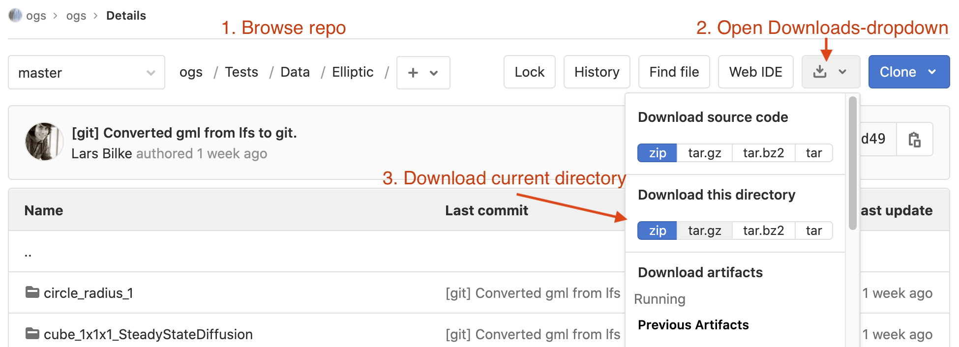

Download benchmarks
You can download the latest benchmark files from GitLab:
  • On our OGS repository on GitLab browse to the Tests/Data -folder
  • Browse to the process subfolder you are interested in, e.g. Elliptic (1.)
  • Find the Downloads-dropdown (2.)
  • Choose an appropriate format under Download this directory (3.)
  • Uncompress the downloaded file
See the Benchmarks section for more information on the benchmarks.
Instructions for downloading benchmarks
